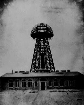

"There have been many attempts to harness electricity from the atmosphere and most had bad endings."
Tower
