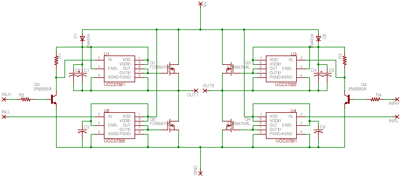

Is it possible to do away with the GDT and drive the semi's directly from the UCC's?
From my understanding the GDT provides isolation between the bridge and the driver circuitry. Is there any way of achieving this using blocking caps, or is there another way?

Assuming you mean a full-bridge, you'll need to use a GDT to isolate the drive when driving with low-side gate drivers such as the UCC3732x chips. A blocking capacitor won't work since the level you are attempting to isolate is AC and not DC (remember its swinging at the operating frequency of the bridge)
There are also high side driver ICs which you can use instead of GDTs and optocouplers could be used as well.

I think Desmo is asking about e.g. in the case of a single transistor, connecting the UCCs straight up.
Just for imagination's sake, consider a fullbridge of MOSFETs... 8 UCCs (4 inv. and 4x norm.) and four 12V batteries. Do you mean isolated power supplies for each pair of UCCs/FET, Desmo, thus no GDT? ^^

For a Half or Full brige there are lots of complicated options, using optoisolators and/or levelshifters to get the drive potential up to the full floating voltage. If you are driving a single transistor, there is no need for a GDT except for impedance matching purposes.

Posts: 43
Hmmm. I used a bootstrap circuit in my segway's H-Bridge. Check the high side of my design here:
