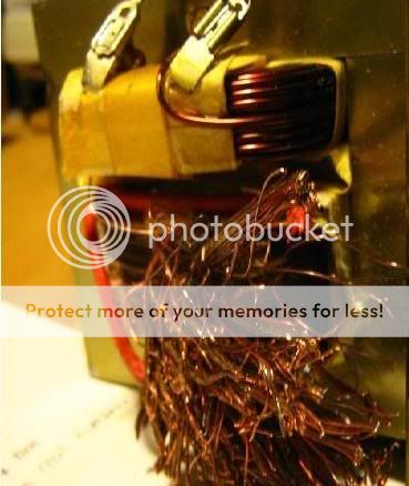

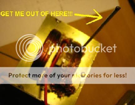

In vain, I spend much of yesterday and a few hours today trying fruitlessly to tare the secondary out of the MOT.
So far, I lost about: 1 screwdriver, 1 Drill bit, and a little bit of dignity :(
There has to be a easier way of prying out the secondary then using a hacksaw. I tried using a carbide tip drill bit but after repeated abuse, it snapped. In trying to punch a hole to the other side of the MOT through all the windings, my screwdriver got lost in the tangle of wires. I then switched to a Dremel but it really didn't seem like it was going to cut through all that wires anytime soon.
If anyone has any suggestions for taking the secondary out of the MOT any faster, please let me know.

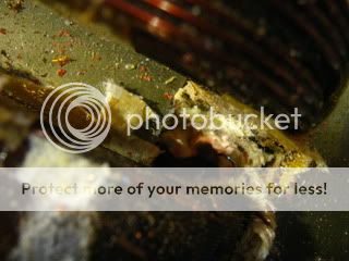

I've managed to pull out the shunts and the heater windings but it the secondary still seems to be firmly in place. I noticed that there are very sturdy wax papers around where the shunts used to be and it's causing problems for me to pull the secondary out.
Here's a picture
IMG 0211
Dr. Slack
Mon Jun 29 2009, 07:13AM
Location: UK St. Albans
Posts: 1659
It's a process of attrition. If the shunts have gone you now have some space to work. I reckon that in a screwdriver will be harder than either wax, paper, or both together. Use it, or some other slim sharp tool, to shred / damage / worry / wear / tear the insulation around the hole left by the shunts. Eventually, the hole will get bigger. Keep it getting bigger, especially in the direction of the secondary. When you get to the secondary wires, don't stop.
