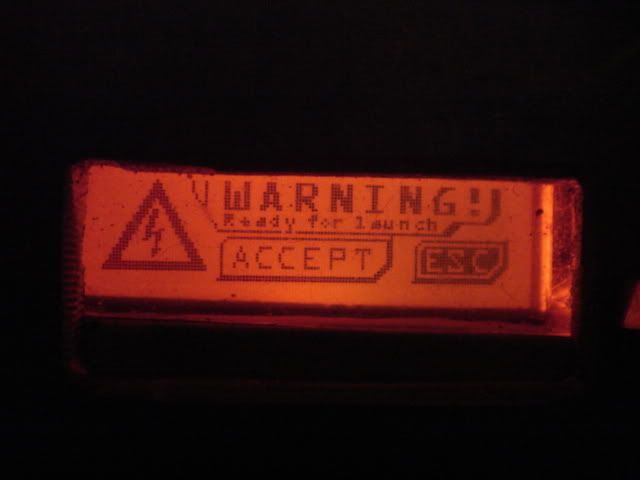

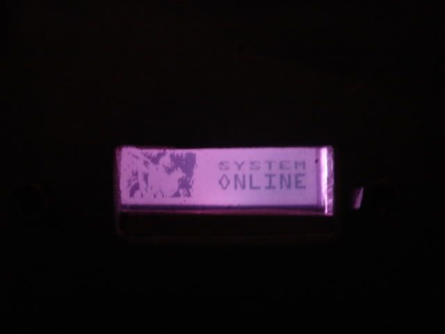

Well, got this babe running at last. Was a hell to code it, especially for the firmware being both my first firmware and my first asm program :) Decided to write it from scratch as I dislike rip-offs. No point in schematic - it's just an AVR core (used the Olimex AVR-H-128-C header board for it has mostly only the atMega itself - and I was lazy to make anything :) ) rigged to the input encoders and trigger button, input board with 7805, SOIC UCC37322 (useless - but what had I to do if I needed something small with only one line? ;) ) as an output buffer along with bypass caps for both - and two other boards I made for the CoG LCD with the backlight module and for the ENTER/ESC buttons along with the LED strobelight with it's driving transistor.

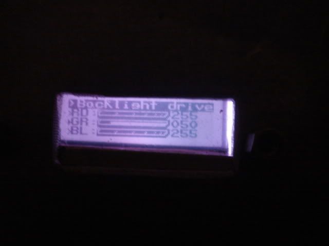

The firmware is pretty useless, but is a real fun to use - functionality-wise it's nearly a good old 556, but with a counter mode for burst-length calculation and osc-swap button for better control. However it's nice - features an i2c emulation to use PORTA for full LCD control (integrates write-mode i2c and additional firmware-controlled RESET strobe), some nice GUI with frontend screen, launch warning dialog, menu-based setup and graphical sliders. The menu system itself is pretty distributed - it allows you to tweak encoder sensitivity that has effect during the runtime, the LCD backlight color (hehe 24 bits!), LED strobe intensity, separately set the timebase for the burst calculation for both oscillator modes and simulate a run with an internal interface where you slowly and accurately can tweak each delay before the actual run. The menu navigation is done with the same encoders as used during a run as the "resistors", tweaking the parameters can be accelerated if you need to make a long scroll - if you hold the ENTER button, the encoder increments each line by 15, not by 1. Each tweakable parameter is rendered as a "slider bar" interface, so needs way less attention which is really necessary - the screen is only 8x25mm, and displays 4 lines of text in the menu mode. During the runtime, you can change the BPS, burst length, burst repeat rate (one more advantage over the 556 - the burst refire rate is independant of the burst length) using the two encoders (the left encoder acts as a burst refire rate control unless you hold the ENTER button - otherwise it affects the BPS) based on the increments you've set up during the configuration part via the menus. The side "trigger" button resets the burst oscillator and applies a different bps-length-refire delay configuration to it for the time it's being held, therefore can be used for the "machinegun effect", for firing single bangs whenever you want, or some other cool things like running a generic 5bps loop suddenly jumping to a high-power burst mode and then reverting back. Also the breakrate-based timing option allows for the accurate burst setup when needed (in this case, the burst length is BPS-locked, so changing the breakrate also changes the burst length), so allows for a cool soft transition from a slow 5bps mode into a nearly constant high-rate burst (slowly adding breaks one by one into the burst looks really nice). I'll make some video of all that - those tricks are pretty interesting and fun, just I didn't get used to this control yet so didn't figure out all the nice things it's capable off.

online
the intro screen (macro photo) - the dust is not on the LCD, this is just the shield that got dusty after being put in the box. The edge looks scary - but huh, the hole is only 1cm high, don't forget it!

backlight drive menu (two pics above were made after I set a non-default color)

"accept" - or you've not put your hand far enough from that thing?
