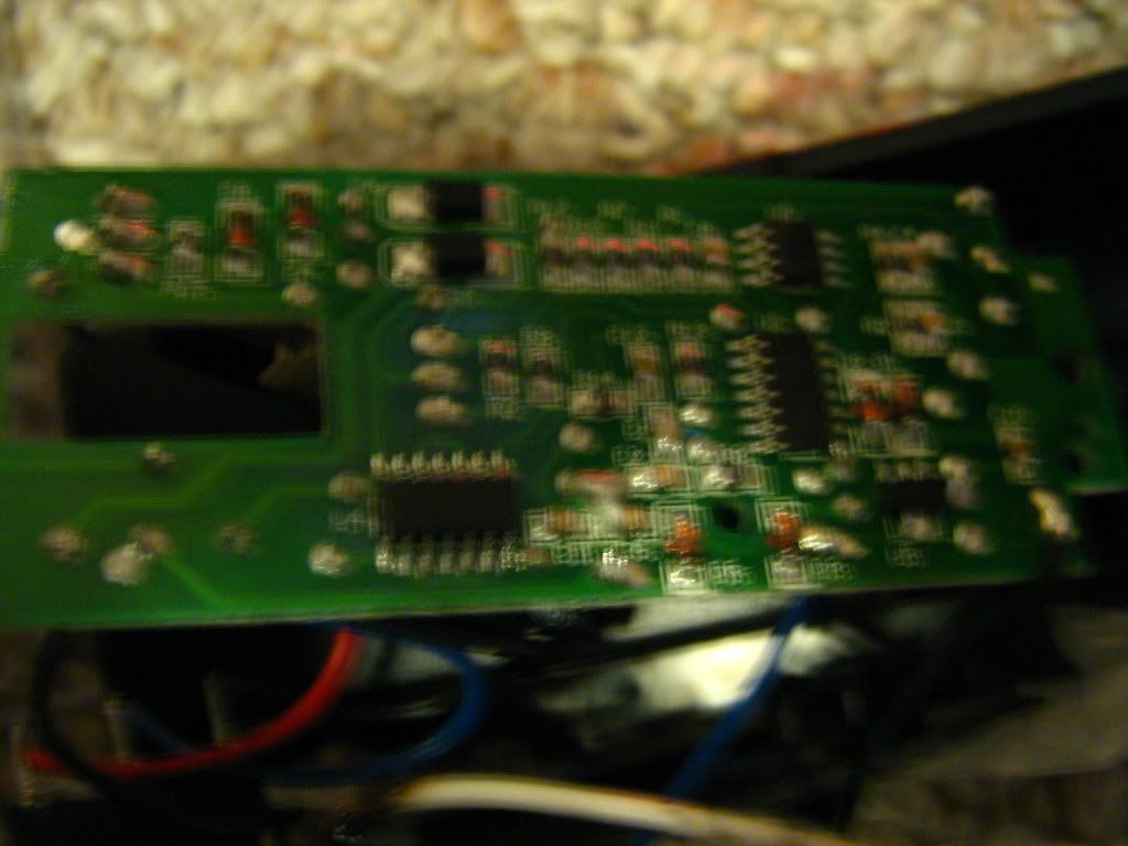

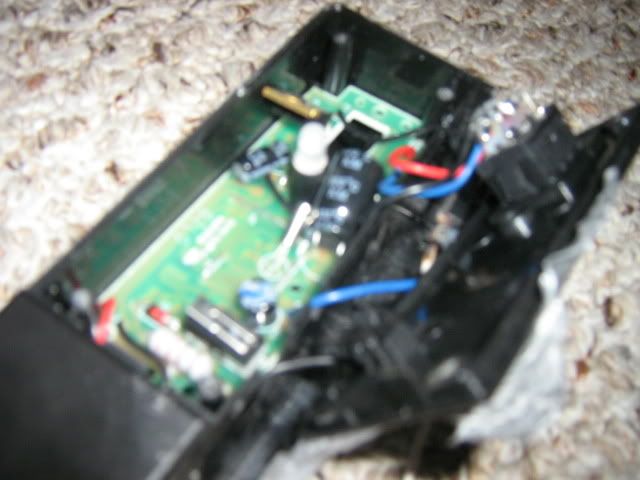

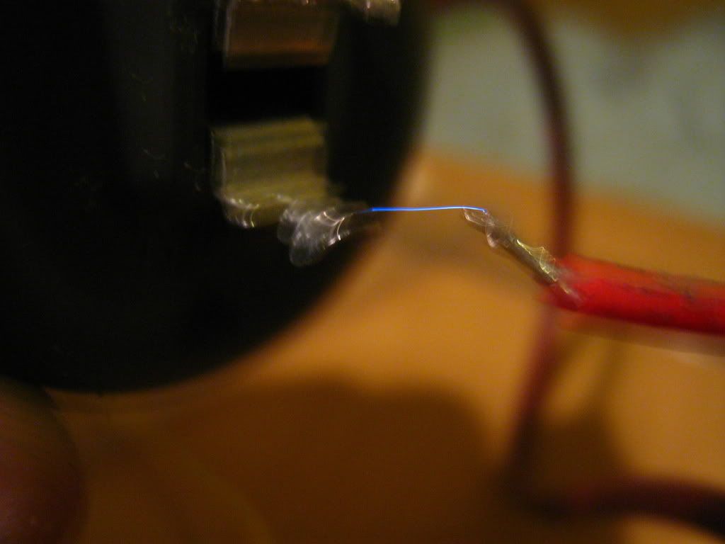

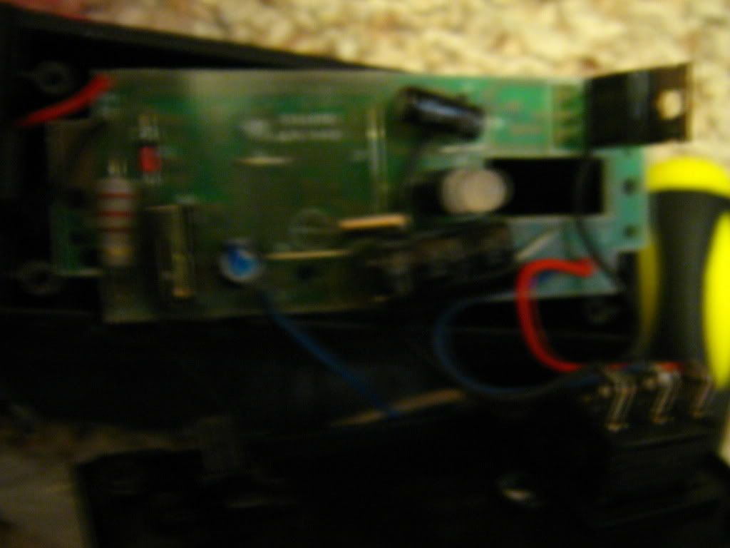

Almost an year ago, I was staring at a electrical mouse killing trap. I bought one home and inserted the battery and turned it on. I reached inside and poked around until a painful zap that I felt made me jump up in the air. I went back to the mouse trap and noticed a 2.7 KV output with a very few mAh. I opened up the curcit and found a driver curcit for an odd type of bar transformer. I disconnected the wires from the bar transformer and hooked it on to my flyback. It worked great. I will post pictures.

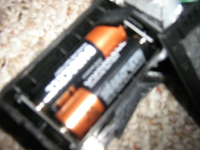

I am familiar with this circuit. It is rather complex (IMO) and uses quite a bit of not so simple (to my eyes at least) design. I pulled one from a trap that was out of service as I really thought this worth of study. If you can't come up with the picture; say so and I'll post mine. I wish I had it written out as well. Quite a few transistors and a bar coil with seemingly two layers separated by paper. Circuitry was quite small (SMD) and the input was 4 AA batteries.

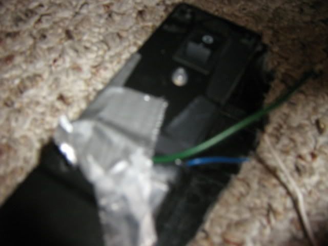

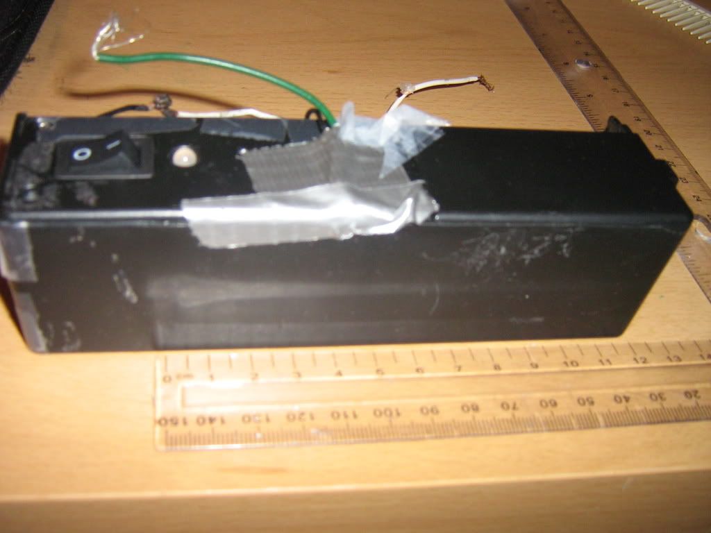

Here, I got the pictures. Sorry for the delay, slow Internet connection.
I agree that the curcitry inside is complicated by it is pre-done for you so that there's no hassel for you to take out your solder.
My Pictures came out sort of blurry mod edit: not to mention far above the 400 pixel width limit :P

~The "mouse trap" appeared to be an over complication as to it's circuitry. I really couldn't understand why the inventors just didn't go with "simpler is better". As I re-iterated, I have one, torn down and when I looked at it: it appeared to drive the voltage up then pull it done again just to drive it up one final time to achieve a wee bit more current at a higher frequency. A very round-a-bout way of getting what could be done with a larger initial supply. What's more the design is very interesting but it was meant to be used under conditions that could present a challenge. Dust, moisture and dirt would make for a fast short within the traces, which are almost on par with 1980's small stuff (it's pretty small!) and uses components that really were not meant to be field mouse trap material. <grin>
I'm keeping mine specifically as a learning tool as the design is pretty interesting. Sections of it are worth extrapolating and posting on the board. I only wish there was a way to obtain the schematic.

I've been looking closer at the example of this "mouse trap" and lit it up to examine the arc.
Some models are stronger than others. The complication of the thing's design made it more and more interesting. What they have designed is a HV high frequency device that is switchable upon a short. Thus when the thing is armed the rodent trips the device (by shorting it with its body) and the thing delivers a powerful shock which continues for a set period of time; then switches off to protect the circuit; re-setting itself.
The purpose here appears two-fold. First to allow for multiple methods of entrapment. Second, for it to protect the circuit from a continually "on" discharge. The use of the IC's for this timing-arming technique is clever for this application.
Several makers have implemented the concept. One uses a rod-core coil & a higher level of miniaturization than the unit pictured.
