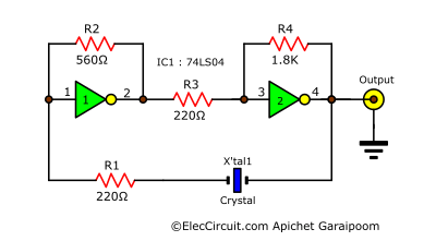

jdub1581hv
Fri Feb 19 2016, 04:15PM
jdub1581hv Registered Member #55219 Joined: Tue Jun 09 2015, 11:21PM
Posts: 80
again we are lloking at the same thing... I have a few 4.0mhz xtals.. but never used before..
Can anyone say how stable this might be?
Oscillator
klugesmith
Fri Feb 19 2016, 06:11PM
Posts: 1716
jdub's circuit is for using a bare 2-terminal crystal (passive component). Change the crystal to change the frequency.
Sulaiman pointed to some crystal oscillator components, which are easier to use. Connect appropriate power voltage (3.3 or 5 volts) and get a corresponding logic signal out.
In both cases the frequency is fixed. Worst case frequency error of +/- 100 ppm (0.01%) is a pretty loose tolerance for crystal controlled oscillators.
Your 74LS624 is a voltage controlled oscillator chip. VCO, not VCXO. No crystal, and you can tune the frequency over a substantial range. How are you planning to measure the frequency, if you don't have an oscilloscope? You could divide it down into the audible range (e.g. with one CD4040 or CD4060) and listen with headphones or a small loudspeaker. Instrument-tuning apps on smartphones can convert a tone into a number. Or adapt an old auto service dwellmeter/tachometer, which I could send you for cost of postage.
It's time you learned more about logic IC's. Jump on in; they don't bite. Get a plug-in breadboard to play with -- apparently as popular now as they were decades ago. There are other forums to learn at.
