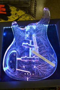

Following is one of the acrylic guitars we irradiated. Since they were all pre-machined, they all self-discharged as they passed through the beam.
1385314708 118 FT0 Dsc 0830a
