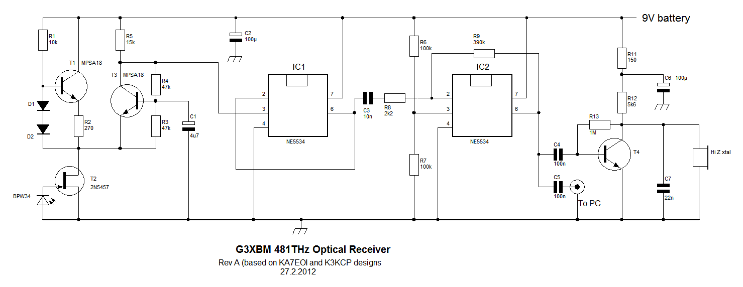

Wed Jul 24 2013, 07:04PM
See Link2
Also the same setup could be used to receive optical amateur radio signals, with the addition of a simple polarising filter and two diodes to filter out ambient noise.
Another worthwhile hack, harvesting the ultrabright diodes from broken optical mice as these are exceptionally efficient at 100mA pulsed and can be ganged in 10s as a phlatlight replacement.
Sulaiman
Thu Jul 25 2013, 12:31PM
Location: United Kingdom
Posts: 3141
The capacitance of solar cells is so high that above a feq Hz there's nothing,
also noise levels are high, as are leakage currents.....
Sat Jul 27 2013, 09:37AM
OK, thanks for that Sulaiman.
I did wonder about the capacitance issue, there is a workaround if a simple resistor is used to discharge the capacitance peridodically at say 50Hz, any signal will show up in the quiet periods.
This approach synchronised to the mains frequency would also reduce interference, and provide an effective way to distinguish a true signal from someone's 4G phone etc.
