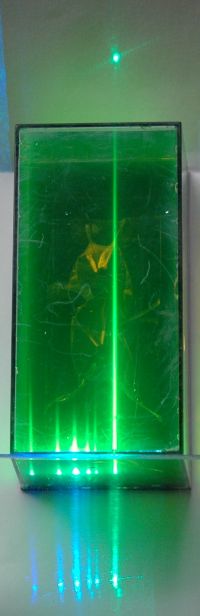

It is a multiline laser with the main lines being blue 488nm and green 514.5nm.
The beam here is split with a 15000 lpi diffaction grating and the first order spectrum passed through fluorescein which filters it to green only.
I would like to filter it to the violet beam only. The violet line is the leftmost one but the colour doesn't reproduce well.

This is a pic out of my shed with a 10mW HeNe for comparison.
Peter
1140245350 10 FT1342 Laserarheneshed
