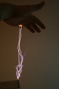

Mark I - The beginning (Started 09.02.2008)
Almost four years ago i got bitten by Solid State coil bug and after some googling i decided that Steve Wards MiniSSTC was the best way to go.
I bought some magnet wire and components from local electronics dealer including terribly expensive IRFP460s (4.5eur each). Also 2.2kVA variac and Tektronix 2235 oscilloscope were found for reasonable price.
I carefully copied Steve Wards circuit on cheap stripboard and then wound about 950 turn 110mm diameter and 300mm long secondary with 0.315mm wire. Few layers of polyurethane was applied. My first bridge was full bridge because i was looking for some power from the beginning.
I got almost all components done but then suddenly lost interest when i had troubles with finding correct phasing for GDT and i didnt get that damn thing to oscillate. At this point the project was put back on the shelf.

Almost 2 years passed and things changed quite a abit. I moved to another city and when collecting stuff from my old apartment i once again found the original Mark I driver card and secondary coil. This time i had plenty of power available, lot of good Fairchild 44N50 Mosfets and 3 phase variac.
Bridge was put together on huge heatsink with copper heatspreaders. Idea was that electric insulation pad was between heatsink and copper piece and mosfets were sitting on bare copper. This is only picture where you can see the almost 4 year old driver card i made back in 2008. Clas Ohlson provided nice 300mm diameter stainless steel ball for topload.
