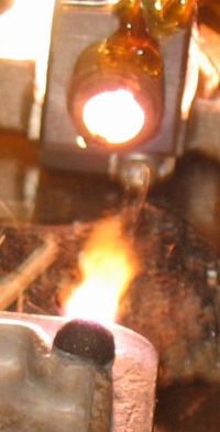

It all started when I saw someone with about 50 ssy-1's for sale on ebay, and I decided to buy one for myself as a graduation gift tongue
While I was at it I picked up a box of 4 of the pfn's
About 3 days later when they arrived I completely took apart the laser (and found it to look brand new), and separated the parts of the pfn. Then I started looking for some goggles... I e-mailed spectronica, and waited a week with no response. Then I was looking through a drawer of 'junk' my dad had brought home (when Ortel closed it's new facility they had a surplus of free stuff they gave to the employees) and to my utter bliss found not one but 2 pairs of od5 780-1080 goggles suprised That was about noon sunday... Then I had other stuff to do, so at about 8pm I started building a supply for the laser... Just a simple voltage tripler of 1n4007's and 3ufd/400v poly caps, powered off my 120v-240v isolation transformer plugged into a variac, with a 80k bleeder, and a .063ufd cap with a mid sized trigger transformer and a radioshack special red button. I hot glued the caps in their sides to make makeshift legs and made a relatively nice power supply for the laser. Then after figuring out which side of the laser was the output side, I hot glued a focusing lens out of a junked green laser pointer on the end of it. Then I vaporised some toner, and realised that if I gave it more than about 700v I got air ionisation shades So I played around with that and at about midnight I sent to sleep.
Then I got up a 6:15am this morning to go to my uber l337 internship and thought about the laser all day, until about 5 when I got home to play with it. Then I managed to get some pics to show you guys... All of the shots are at about 750v (10J) made with a 3 second exposure with a weak flash for background along with a little ambient light (I need to see too...) Except that last one...

1151380208 56 FT0 Bpb1
This is a ball of black powder being shot (it lasted about 20 shots and didn't ignite

ragnar
Tue Jun 27 2006, 05:52AM
Posts: 1425
Not bad at all. Got any practical applications in mind? =D

The laser is just an unmodified SSY-1 that you get off ebay... It has a 50mmx4mm rod YAG rod, a passive q-switch... next to a 1.4" strobe tube, all in a permanently aligned chassis (all of the important spots have been very carefully ground so you are guaranteed perfect alignment smile ) with 3 wires hanging out... The main power supply is a 36ufd/900v polly cap, with a .03uH inductor in series with the tube (the guts of a PFN-1 unti, also off ebay), to which I added a charger (voltage tripler off a 240v isolation xformer) and a trigger circuit (.063ufd cap and a trigger coil out of a mid sized strobe light) which isn't too reliable (usually takes 2 hits of the switch to make it go, but 90% of the time it will go on the second hit confused )
I personally am not a holography person, there isn't enough that explodes tongue
My plan is to mount it vertical pointing down pointing at an x/y optical stage with a piar of Newport 850g actuators ( they are supposed to have sum-micrometer precision amazed ) hooked up to my controller which will be on a gpib buss to a computer which will be probably be running labview (should make things easier to get things going quick) and controlling the laser (I need to make some sort of pic controller for the laser that controls charging of a little smps charger and has things like overtemp shutdown) to make a little laser etcher cheesey I can probably go 1shots/second at 10J, each spot making a hole about .5mm in diameter (or larger if I defucus it, I can etch a shadow about 3mm) which would let me go about an .1 inch a minute of laser etching. Or if I need to go fast I can handle up to about an inch a minute. amazed

There is a shot of me blasting away at a 555, and while it might be possible to do it it would take forever with a ssy-1 (although I am thinking of setting it up for a 15j shot once a second for like 10 hours to see how far in I make it....)
Although I worry that the top of the die might not be reflective enough to save it...
