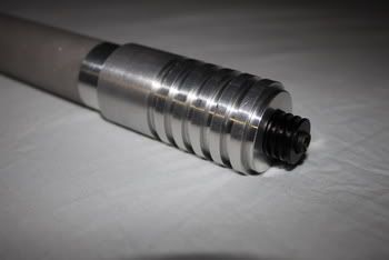

Here is an example of one of these heatsinks, I built it for a handheld version.
1
The heatsink itself is part of the laser body, most comonly just called a host, this case its handheld so it also houses the driver (boost converter, 3.7V battery to 4.8V for diode) and the battery itself.
With a good heatsink around your module, you can achive quite long runtimes, and even constant if done right.
Hope that clears it up.

Yes, you need it. Im probably exadurating on that 10 seconds, you can probaby do ~30 with that module, but keep in mind these diodes dont like that high tempertures.
That heatsink I posted keeps my 1.2W in constant runs. (and the whole body is only a few degrees above room temperture).
Although this thing is big, its about 8-9" long by 1.5" wide at the heatsink, thus can dissapate alot of heat without the need of active cooling.
