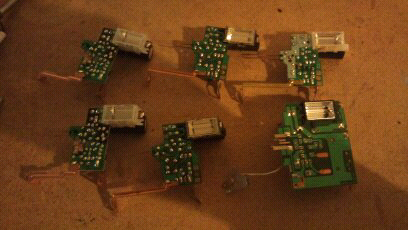

Hi there, finally started getting parts together of a first build, I got 6 used disposable cameras from a shop today, 4 of them seem to have the same innards, the other two are both different.
The 4 that are the same don't have any specs on the caps, but I guess they are 330v 80/100uf, the other two are both 300v one is 100uf and one is 80uf.
Now, assuming I use one of the circuits as a charger, which is best? 5 are almost the same, one is much larger with wider tracks, I'd assume this would be best as it could handle larger currents through the PCB. This one has the 80uf cap. Though on the other hand, that one has steel or something for contacts, the others are copper.
These are the boards.
46
edit: I was also thinking could I use the charge LED power to trip a relay so it disconnects the charger when full, then automatically restarts after firing?

Definitely bank the 4 chargers in parallel, using one charger will be ridiculous charge time... unsolder the battery holders and the flash tube. Solder the button closed/down so that the circuit charges as soon as you have a voltage input and charge with no more than 3 volts, over 3 volts burns out SOME chargers. in my gun I have 10 similar or maybe even the exact same charges that you have (the 4) and they charge a 1140uf bank of capacitors in 8 seconds to 330v using 6 NICD cells at 3.6volts (parallel and series connection).
I have never disconnected the charger when firing, I just shoot and the chargers automatically start charging again.
Any more questions I'd be glad to help :)

One other thing, I'm not sure about the charge indicator, would the one on the boards still work as normal?

Yeah if the chargers are paralleled together the LED's on them will all illuminate at the same time :) They usually turn on around 280 volts though and stay lit how ever high you want to charge. I wanted to see if the chargers would overcharge the capacitors to the point of explosion, so I let them charge for over 5 minutes and they just sit at around 350 volts. I didn't have any problems with it at all :)
Also only parallel them if they are the same chargers, I don't know what would happen if they are different brands.

Thanks man! Those pictures look like what I had in my head when you said to put them in parallel. I have two circuits that look identical to yours, and two similar. Ill use the two identical ones for now, then so the nice lady at the camera shop for more!
