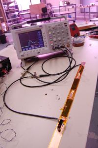

I have been trying few set up with out much success until one hour a go,but it's work ,definitely, with a basic set up I can get the voltage increase by 1/3 and a definite pulse sharpening effect,the induction are made of soft iron from a transformer ,3 plates on top of each other and the one in the middle have few turn of copper tape around it ,the capacitor are made of the very same copper tape and kapton tape,I use a microwave contact switch to dump a capacitor in to the rest of the PFM the scope is set on 50 ohm input with 10ns per division,the rising time don't look to affected by the poor qualities of the inductor...
1285863516 2941 FT97555 Tek00000
1285863516 2941 FT97555 Magnetic Pulse Compression

from all I know there is at list two basic configuration,one witch increase the voltage and one witch compress the current,
it should not be a problem to use it with a solid state switch,that's what I am trying to do...
I try the set up in low voltage because it's a mess to measure the pulse in hv with the scope ,and you need good dielectric all around ,but apparently some people manage to stack every thing on one coax,how cool is that!!!
I suppose the coax is use as a capacitor and some ferrite is place in between the center wire and the shielding at the right place ,
sort of one pass inductor...

Thanks for posting your results, they look interesting.
One question though, in your setup do you think that magnetic compression is responsible for shortening the pulse? Is the magnetic core actually saturating?
