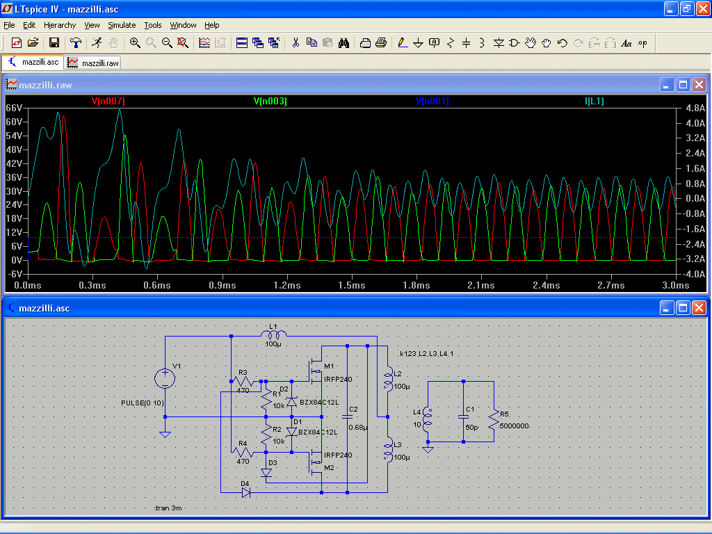

This simulation is not showing the normal operation of this circuit. The output transformer seems to be ideal, the series inductor (63 mH?) is far too large, and the waveform shown does not make sense.
A more realistic simulation:
Essentially, this is an oscillator that resonates the capacitor across the two primary coils with the coils.
