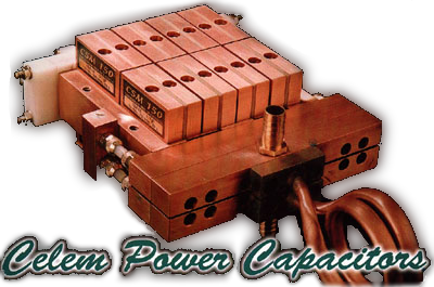

Anyone here used one and water-cooled them? I just got one and it has nipples for water tubing for each plate on one side. On the other side are just flat holes. Am I suppose to let the water just run out into a bucket?

I appreciate the reply, but that was not my question. The Celem capacitor has drilled holes in the copper plate without nipples or threads on one side. My question is what does one do with this? Do I just let the coolant (water) drain out? Do I wedge a piece of tubing into the hole and drain through this?
This is a question only someone with one of these would be able to answer. My question involves the method one makes the connections for the coolant to the capacitor.

the fraction of members that actually own such a capacitor may be low, so we would enjoy seeing a picture of it. Does it look like this one?
Sat Apr 17 2010, 10:01AM
I have a Celem capacitor, but it just has flat plate terminals, I had to make my own water cooling blocks. Maybe yours was supplied with cooling blocks that can be unscrewed?
You are supposed to attach tubing somehow. Water squirting around high voltage wires isn't cool. Maybe the flat holes are supposed to line up with orifices in a manifold that has O-rings or something.

Here are pictures of the front, top and back.
The front has two connectors for tubing. The eight screws are electrical terminal connections. The back has springs threaded into the outer two holes on each side, which dead-end. The center hole goes straight through to the other side, but is flat on the surface. The pen on the bottom picture is pointing to one of them. I probably need some insert with an O-ring as Steve suggested.

I have made a connector using some nylon tubing connectors. I have tested it while pumping 200 G/min through and it was nice and dry. I will post pictures of the finished product when it is completed.
