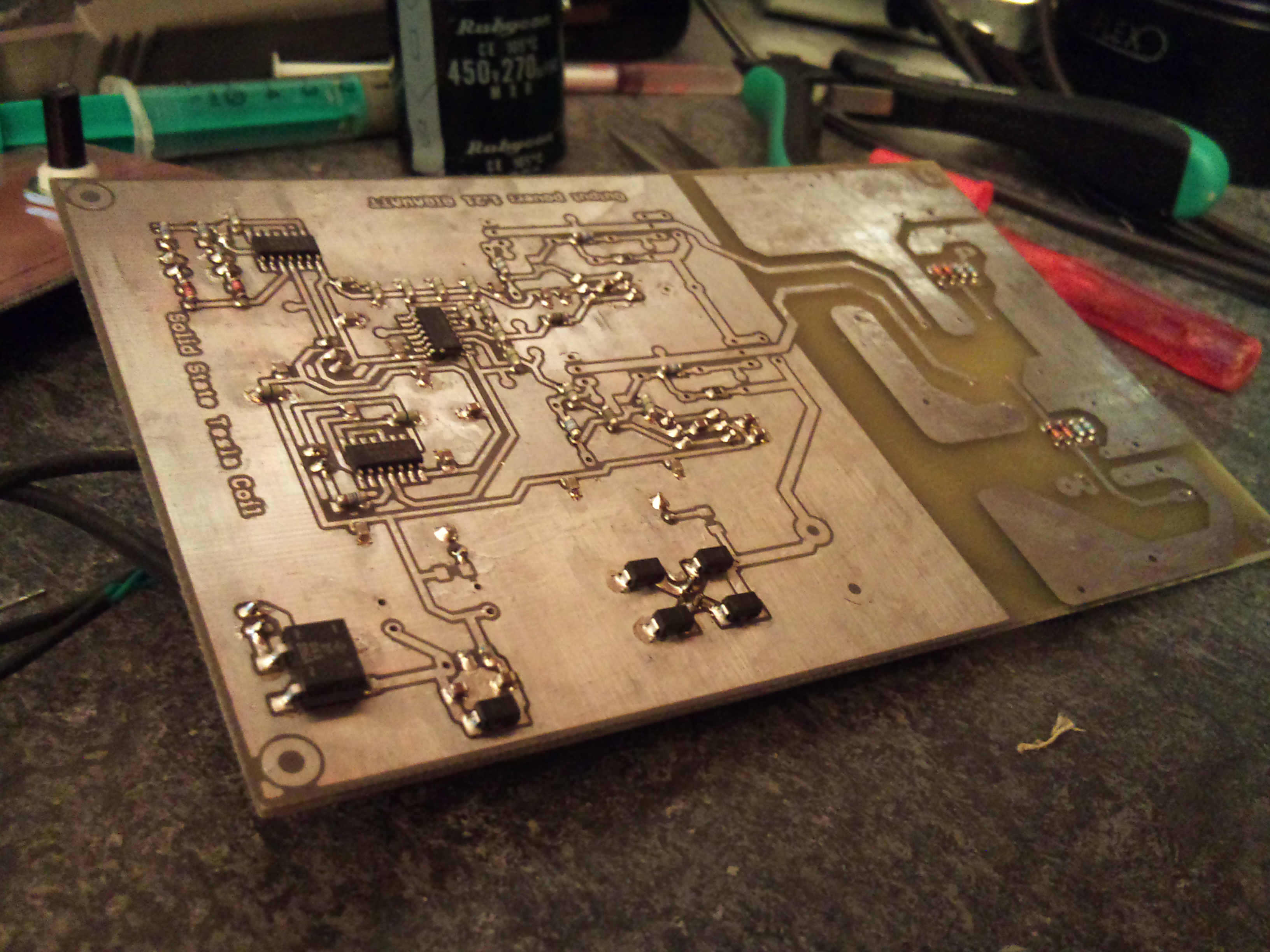

Hi,
after a long time i´m back, building new sstc
oscillator and interrupter are based on 4011, driver will be a fullbridge with irf9630 and irf530/630 and a GDT
the halfbridge is made of two irfp350/460 (whatever i´ll find in my box :P) 2x 1,5µF wima capacitors, diodes are MUR1560.
9ck7lio7
that´s how it looks like atm
this evening i´ll finish the halfbridge and the driver as soon as the mosfets have arrived
greets
derju
PS: the layout :P
1268919913 1445 FT0 Sstc

Looks good so far. Do you plan on running it on half of full rec mains? if you do go with full rectified I suggest you get a nice large bus cap.

both are planned
fullwave rec with interrupter or current limmiting and halfwave rec without or with interrupter (only 1 jumper to change from CW to interrupted mode)
oscillator and interrupter are tested and are working well, the mixing of the signal does also work :D

Nice looking PCB. Did you design the board in Eagle? If so, is the GDT a standard library part, or did you design the part yourself?

yeah i used eagle, and i created the gdt on my own
time u need for this is maybe 5 minutes, even without knowing how to do^^
the mosfets for the driver should arrive tomorrow, so i can finish the sstc on sunday evening and o the first tests :D
