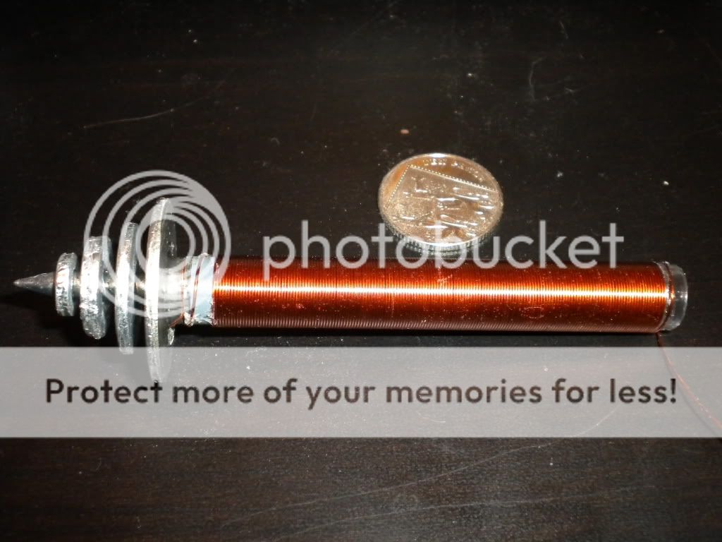

DSCN0051
thats the secondary and topload. im basically making it for a model so its going to look a bit like a evil tesla coil robot its going to be on a base so i dont think the size of everything else is too much of an issue. what would be better for the cap bank a car coil or the other caps as listed. was thinking of using the 2 2000v 0.33uf in series.

In that case, you could try and rectify the output of your ignition coil and use that to feed the SGTC. You'll want to find or make some caps that can stand higher voltage, say 50kV. Some simple rolled transparency sheet caps would work great and be cheap.
You might also want to wind your secondary with a higher gauge wire. It looks like you have 22awg or something; try at least 30 awg.

its 26awg but ive had a load of it left from my last coil so i thought id try and use some up. 50kv! much higher than i thought! do you recommend any particular caps? Link2 was looking at these. 50 seems mad!
