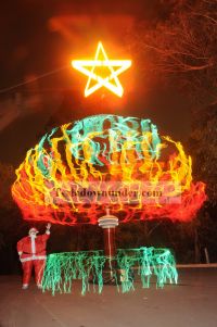

I am well under way in the production of my Xmas tree for 2009.

Hoping to emulate and improve on this, I have begun work on a different and larger design.
I first used a rotating swivel arm to have sparks to Earth then streamers in the air. The effect is to have a Santa next to a colorful bushy "tree" with a golden star on top.
Here are some pics during development, experimenting with colors.
Note the larger size with the star yet to be added.

I have just completed the Xmas tree still pic and I am very happy with it - after about take 20. Now just have to complete the construction and explanatory pics and text and send it to my agent.
I will publish it to my site with a water mark later. in the meantime here are a couple of extra shots.
My car innertube toroidwent flat and started to burn so I did a quick replace job with aircon ductng to fit around my motorised rotating arm.
The other shot is of green sparks at my feet, These tend to fan out on hitting the poorly conducting bitumen.

The TC former is a custom welded poypropylene cylinder with internal bracing and flat overlapping end caps to allow bolting onto the base and with reinforcing to allow the mount for the secondary rotating breakout mechanics. Cost AUD $250. It's far lighter than a comparable PVC which would have to be thicker and a lot structurally stronger.
The colored sparks are all due to rotating colour filters which are changed manually.
Eg Start exposing picture. Take a picture of foot with flash and clear filter only. This shows the foot in natural color. Remove foot. Change to green filter and fire sparks. Sparks appear green. Stop exposure.

Well, the tree is finished. Image is copyrighted to me and my agency, Barcroft media hence the watermark.
