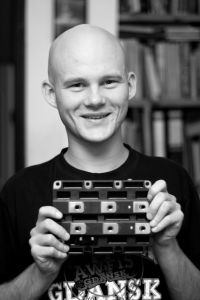

If you could lay your hands on some of these, what would you do with them?

If they are fast enough, a giant DR-SSTC comes to mind...but seeing as how you asked this question on a HV forum in the Tesla Coil section were you really expecting any other answer? tongue

Yes, i suspected that i would get that answer cheesey
And that is what i would like to do if i get my hands on them. (i've seen them at work...)
I think they are fast enough for about 200kHz, but correct me if i'm wrong.

form those big ones are suitable for drsstc only CM's, CM300, CM600 and maybe some others, donno, its just my thought.

those bricks could be used for a drsstc and so can cm300, 600 provided your tesla provided has a low f res say 60k. I bought some like thease to make a bridge. The switching caristic sais that the switching time is about 2us so there are 3 transitions in a full cycle so 1/6us= 166khz for a full bridge. if they are afordable or free 2 would make a full bridge.

something like this?

Do you mean a brick like THIS? shades
1257624344 151 FT79043 Imgp5844x640

Pffftt.....I've seen bigger. angry
