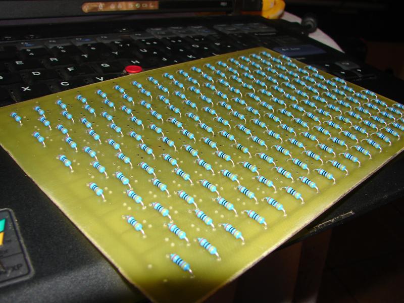

I decided to use 12V for the UV LEDs, as this would work fine with the old AT supply I decided to dedicate to this project. Each LED has a Vdrop of about 3.5V, which means I'll use 3 in series for 10.5V, so only 1.5V will be wasted in the current limiting resistor. Using an individual resistor for each LED is a waste of power, time and resources. I decided to fill a 16x 16cm matrix with LEDs, so rather large boards could be exposed. It would also make the most use of the 100 LEDs I had. The LEDs were mounted on standard veroboard.

Any idea what wavelength and power the LEDs are?
It's always been a bit of a mystery to me what wavelength of UV is needed for PCB exposure. I'd also worry whether the platen glass/plastic transmitted that UV or not. Everything I see suggests the requirements are very flexible so that anything close to but shorter than 400nM is ok, and being near 400nM, anything that's clear to the eye is probably clear that UV too.
Fri Apr 02 2010, 03:54PM
Thanks guys. The distance from the UV LEDs was determined by eye. What I did was construct the LED matrix first, then take an A4 sheet of paper and move it away from the LEDs until I found the beam diffusion satisfisfactory. The exact distance will depend on your LED spacing and their emission angle. The LEDs I used have an angle of about 25 degrees, intensity is 320mcd and their wavelength is said to be 395-405nm. I purchased a batch liek this: Link2
I haven't experimented with trace width yet, as I've only made one SMT board which you see above. If you use a transparency with the ink side towards the board, and space the LEDs far enough away you should be able to get tiny traces, provided your etching and developing techniques match up! The smaller traces in the above PCB are 0,015 inches, I'm sure 0,010 is entirely possible.
