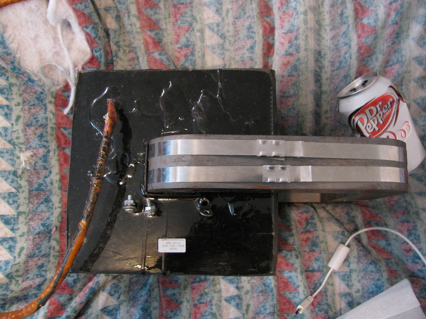

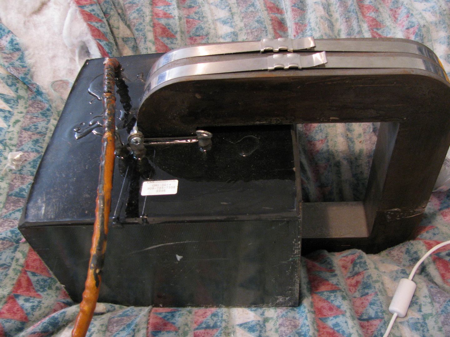

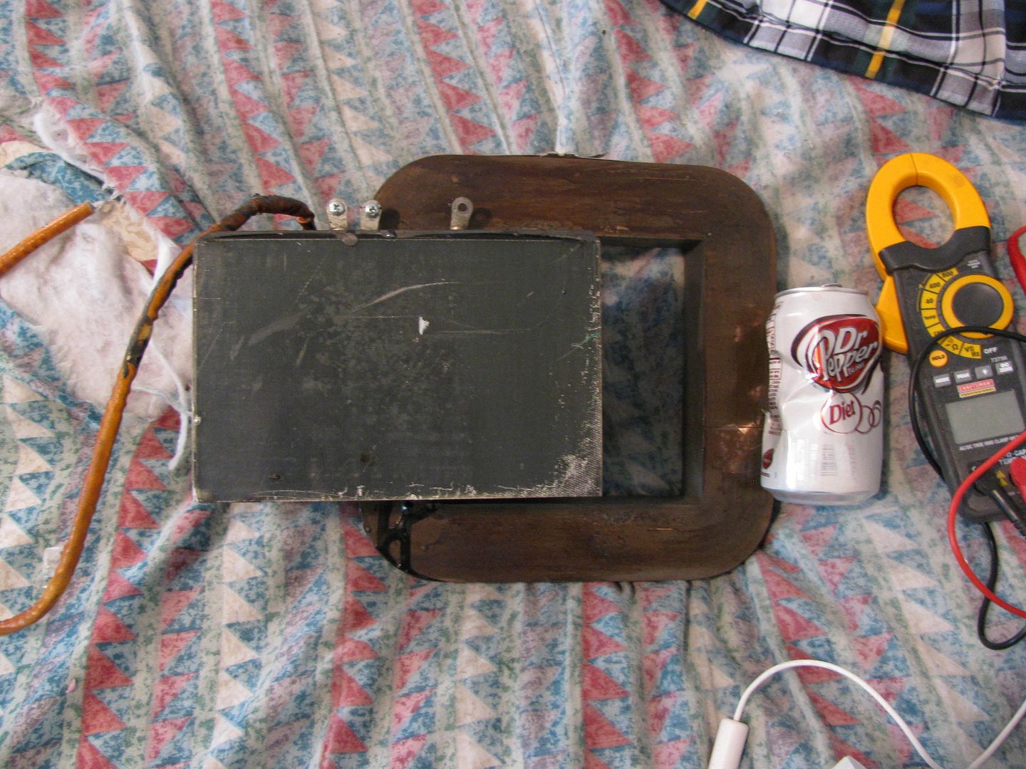

I recently got a big transformer that supposedly came from an electron microscope and I'm wondering if anyone here knows more about it. The transformer itself only has a small label with ((CHI-5014 corona magnetics inc. 909-735-7558 9946)) on it. The ebay listing claims that the output should be around 32,000 volts and 20ma, but I have no idea what the actual current rating/VA rating is. It has one thick GTO wire poking out, the 2 primary inputs right by each other and an uninsulated terminal by the core which is the other part of the secondary. I haven't powered it up yet because I don't know if it needs to be ballasted/current limited etc and I don't want to accidentally fry it.

From what he said in the listing it looks like he was only guessing the output current, I'd say it's about a 5ma transformer myself. But don't take my word, wait and see what the other users of this forum say

I'd say power it up ballasted by a shorted NST (if you have one) or just anything that limits the current to a safe value (fluorescent ballast? the choke type).
If its really 32kV, be prepared it can spark over a distance greater than 5cm.
Also you could tell us the primary resistance and voltage, I can then tell you approximate power rating.

The primary voltage is 120V and the resistance is .5 ohms. For comparison my 15/60 NST's all have a primary resistance of .7 ohms. In the morning I'll try powering it up with a shorted 9/30 NST limiting the current and see what happens.
Update: Tested it this morning and it worked without any issues. I used a shorted 9KV 30mA nst to limit the current and had some fun drawing arcs with it. I still don't know the current rating though or how far I can push this. Here's a short video ;)

I had the heavily insulated wire tied to an insulated screwdriver with a nylon tie. Also I inspected the wire before powering the transformer up and the insulation was in perfect condition. In any event I was only drawing like <10mA from the transformer so I didn't feel like getting the old 4 foot chicken stick out. I still have no idea what this thing is actually capable of though. It weighs 54 pounds and might be good for 30mA or higher for short periods of time.

I guess it should be good for ~1kVA continuous, 2kVA intermittent. I would try powering it with the output shorted and adding NST ballasts one at a time, leave it going for at least an hour every time while monitoring the temperature.

Looks like an x-ray-hv-transformer. From the core size it will easely take 1kVA for continous runs, much more for short runs. I would ballast it with a shortened micro wave oven transformer, this is more efficient than a shortened neon sign transfomer. You could also check the voltage, if you feed just 1V from a variac into the primary and measure the output voltage with a normal multimeter. You could calculate the winding ratio then and determine the exact output voltage for 120V input. The transformer seems to be resin potted, so you don't need any oil. This is a great advantage. Nice deal smile

The shorted MOT ballast really doesn't do a very good job. It pulls like 22A from the wall and puts out big 5''+ flaming arcs. Cool, but probably not good for the transformer. Right now I'm running it with a big space heater limiting the current to around 8amps, but it really weakens the arcs and the heater is making the room uncomfortably hot and wasting a ton of the power. Would two shorted MOT's with the primaries in series do a better job or should I use something else? The bulky space heater ballast sucks.
