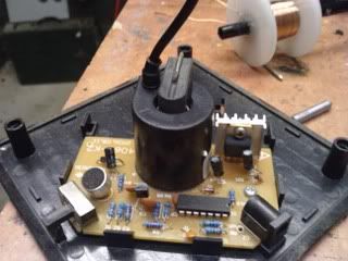

My sister smashed her plasma globe so I took it for parts. I know it has a flyback in it and I've heard people charge capacitors with flybacks. How would I go about doing this? Is there anything I can read to learn how? I'm not that great at making circuits I tried making a photo-interrupter for a coilgun once and it didnt work.....

You must rectify it with a HV diode.
If you want to charge low votlage (<2kV) caps, then there are really better ways of doing so than with "flybacks".

Oh, ok then I wont bother looking into it because I want to charge 300v - 400v capacitors. I might need to look into a boost converter, It's just I dont have access to any stores that sell the componants and I caant buy online..... I think I'll stick with camera flash chargers for a little longer. cheesey
