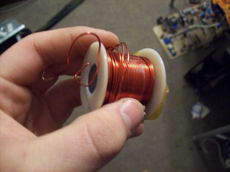

The primary was very simple, but looks halfway decent. I got a transparency and cut it to a good width, put it around a 2.5 inch pvc pipe, and wound. The primary wire is just some enameled wire, around 18-20 gauge found from an inductor. It has 7 taps, in one turn increments, with male spade terminals for easy tuning. It uses iirc 24 turns in all, the top 7 being tapped.

Link2 The inductor that the wire for the primary came from.

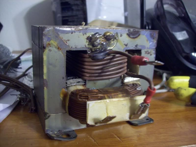

Link2 The rewound MOT for the filament transformer. that pic does not have the secondary on it, and i increased the primary turns for less no-load current and much less heating. Slightly reduces volts per turn, which is about 2/3 a volt per turn now.

I also would like to find a small filament transformer, as having that huge thing that overheats and pulls tons only to power something with about 24 watts. Also a better 2kv plate transformer, as the MOT heats badly even with no load, it is huge (as big as the sparks, i mean come on), and it weighs more than needed. It is mostly about the size though.
