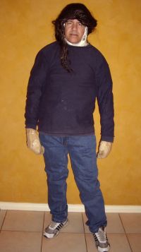

Some more pics. The Thinker statue, one of many copies around the world.
I did try various versions to make myself spark proof. The one with copper foil just didn't look right but did make it safe tested here on my ignition coil sparks.
I then decided to go with an open face mask, using fine steel wire. (I have placed each one of these 5 guide wires deep inside someones chest)
The last photo shows the initial shots of a spray of sparks from the 4 inch TC in daylight.

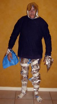

Tesladownunder
Thu Mar 05 2009, 11:39PM
Location: Bunbury, Australia
Posts: 1424
Steve McConner wrote ...
Are you going to do this in the scud, like Rodin's original statue? suprised
I considered it. Pic is NSFW or anywhere really. Perhaps 4HV's first (and completely tasteless) nude shot.

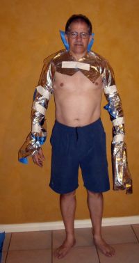

I was originally hoping to use my copper foil to mould to my body but it is too stiff for that and just crinkles. I did try various metallic cloths without success when subjected to spark testing.
I evenually settled on builders insulating foil. This is a foil backed by fibreglass and plastic and is thin but strong enough for me not to be able to tear it by hand.
The third photo shows the initial test with just a simple wrap and TC sparks. No sensation at all.
The last photos show the suit being made up. I had to make the arms in a separate piece and rely on a broad contact area with the main body of the suit. It worked fine.
