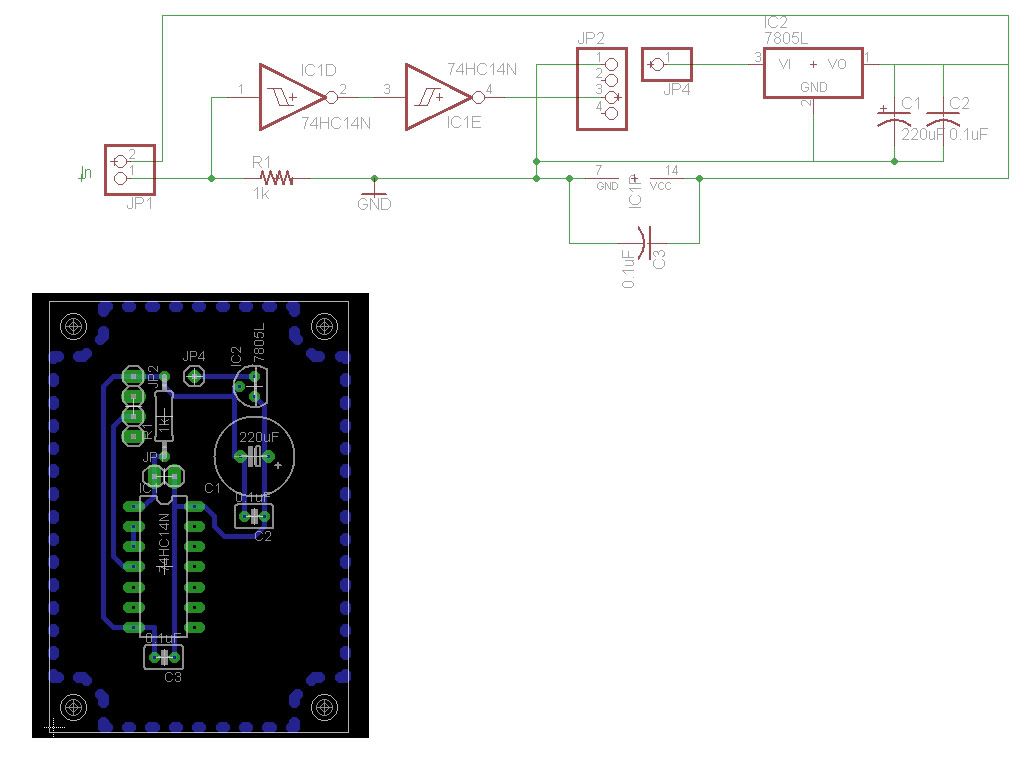

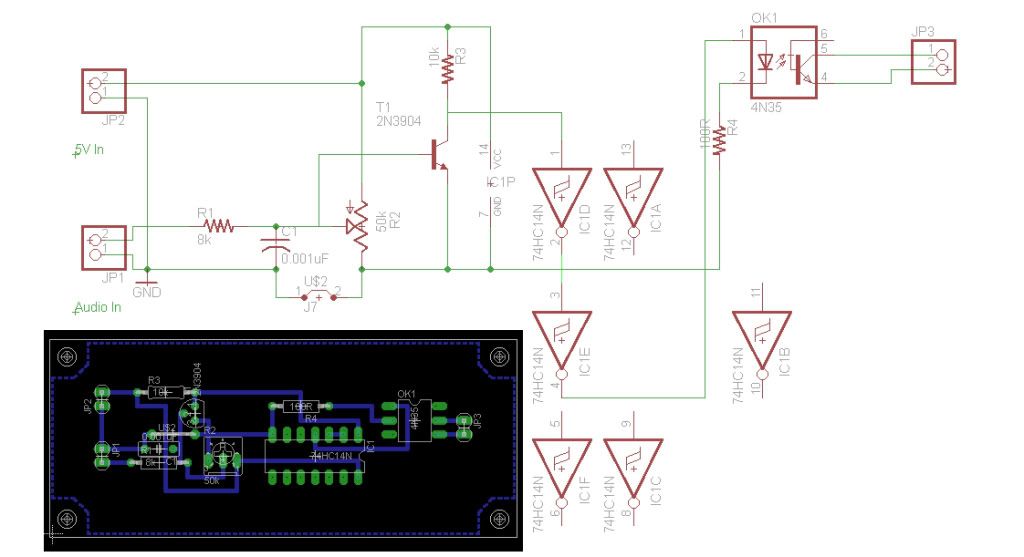

Well since there are a few people that want a schematic of the modulator, here it is:
Transmitter:
Transmitter
Reciever:
Reciever
Just be aware that there is a flaw in the schematics, the actual built version has the optoisolator moved to the reciever side.
Myke
Sat Jan 31 2009, 08:32PM
Myke Registered Member #540 Joined: Mon Feb 19 2007, 07:49PM
Location: MIT
Posts: 969
Maybe you should pull up the inputs of the NOT gates so they don't switch on and off from random noise?
