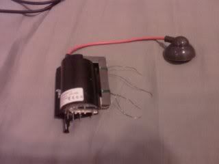

Well i think i have looked at almost every howto online but have not goten far. I built a 3055 circuit and it works, but the output it only like 2-4kv (or 1-2 centimeter) I have tried it with 2 9v batteries (just to get a feel for it before i move up) but also tried a big 14v transformer with 5 amps. But still not much.
this is the flyback, i know it is small so i dont expect much but i expect more.
IMAG0023
The only think i am doing different is im useing a 5 watt 270 ohm resister and a 33ohm 1 watt resister instead of what it calles for (could not fine the exact resisters at frys)
So if someone could help me out. If i need to get a biger flyback i may be able to find one somewhere.

That looks like a mini flyback from a portable b/w tv. Those are not going to give out much power so i would suggest you looking for a bigger one. They can be found in regular computer monitors and tv's the people throw out and they are amazingly easy to obtain. About the resistors i dont think they have to be crucial seeing the driver is self resonant but as long as they are generally close they would work fine. One thing that you should try is to increase or decrease the number of primary turns until you get the maximum amount of output voltage. Good luck and play safe.

That flyback is fine if you want DC. Any 9v battery combo will never work well at all. The 2n3055 driver is really bad. The ZVS driver is very impressive and only uses a few more parts. Your primary and feedback winding are far too small. because you're not worried about turn density, you are perfectly fine in using normal wire for the primary. Anything is better than the windings you have now. Find an old computer power supply and use the wire from it if you can. Computer PSU's are also great to power things, as they give 12v at several (tens) of amps and are easily put in series (after secondary side isolation).

The reason the feed back is fine and you need a larger pri is because the pri will be carrying most of the current to the flyback. You won't burn out the 3055 (actually they can sometimes burn out but not due to heat related issues) if you increase the power supply current. The circuit will draw the same amount of current no matter how much the power supply can put out (the max current for the power supply has to be more than the driver can draw). Right?

The internal primary is bad because there is higher coupling and less leakage inductance, this means it will draw huge currents from your driver when you short it.
It is much better to wind the primary opposite the secondary on the core, as this will result in "natural" current limiting, not saying the internal primary may burn out and ruin your transformer, while you can just rewind the external one...
