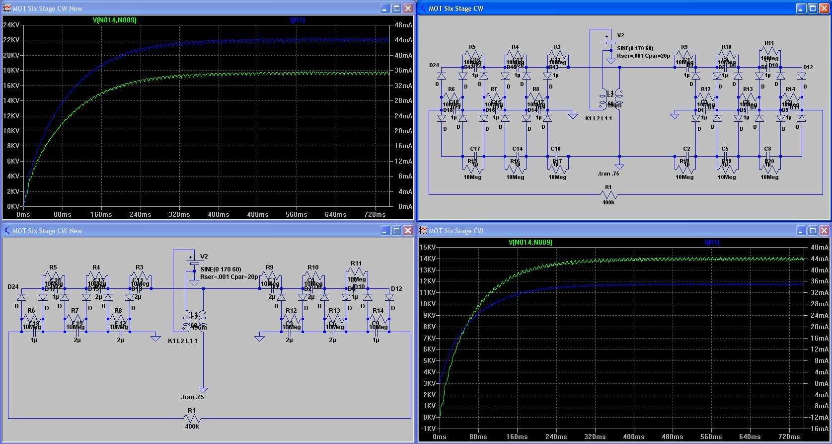

Ok, I'm finally moving on this project again, and I have been doing a little LTSpice simulation to figure out the best configuration for a limited number of MOCs (20). I was originally going to use a full wave multiplier, but my simulations showed that a half-wave multiplier could get better power output, roughly 750VA vs the full-wave multiplier's 350VA. This was using a 400k limiting resistor, which is subject to change depending on what I end up with. LTSpice sim - Full Wave vs. Half Wave Multiplier

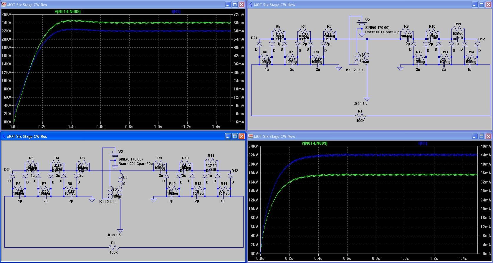

Also, I decided to see what adding a large inductor to the MOT output would do, because my model for the MOT uses coupling coefficient of 1. Interestingly, a 5-9 henry inductor boosted the output voltage from 18kV to 24kV, and the power output to nearly 1.5kVA. LTSpice sim - Inductor vs. No Inductor
Also, I would love critiques on how to make these models more accurate. My ability to use LTSpice is limited, and obviously my transformer model is far from ideal.
