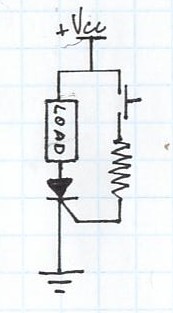

SCRtrig
It seems prettly clear to me, there is a current limiting resistor connected to the gate. The load is clearly connected between the anode and the positive of the power supply.

I see what this circuit does, but the load is connected to the gate.
This circuit uses a battery as the load meaning low voltage 3v and low current, i know that the resistor limits current but this circuit does not work in my case.
I cannot connect the load to the gate, my load is a 450v 3900uf capacitor fully charged so if i did connect it to the gate i would be pumping 450v through the gate when it was only made for 3v.
I see what this does, when you close the switch the resistor limits the current down to the trigger current and it turns on but the load is a BATTERY i am using a large CAPACITOR so if i did it this way i would need a high voltage trigger which my scr is not made for a high voltage trigger.
look at the attachment, will this rig work? or will i have to assemble this some other way. Remember i cannot connect connect the load to the gate!!!!!!!!!!!!!!!!!!!!!!

I don't know what are you getting at. You turn on the SCR by putting a positive voltage (with a current limit) between the GATE and the CATHODE.

the diaagram is correct, but the negative of the battery should be connected to the cathode.
