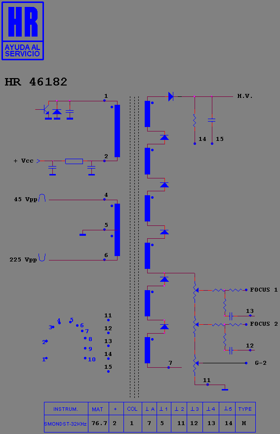

BTW: the windings seperation looks like that the design of modern fly-backs is similar to spiral line generators ("Fitch"). Then it would mean that all windings are separated by a diode which are connected in series.What do you think guys?

Mates wrote ...
That's right.

And this schematic proves it:

c4r0 wrote ...
I see I just discovered America cheesey
