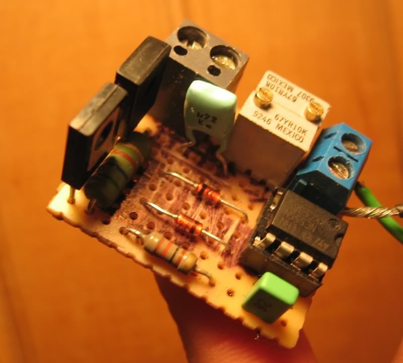

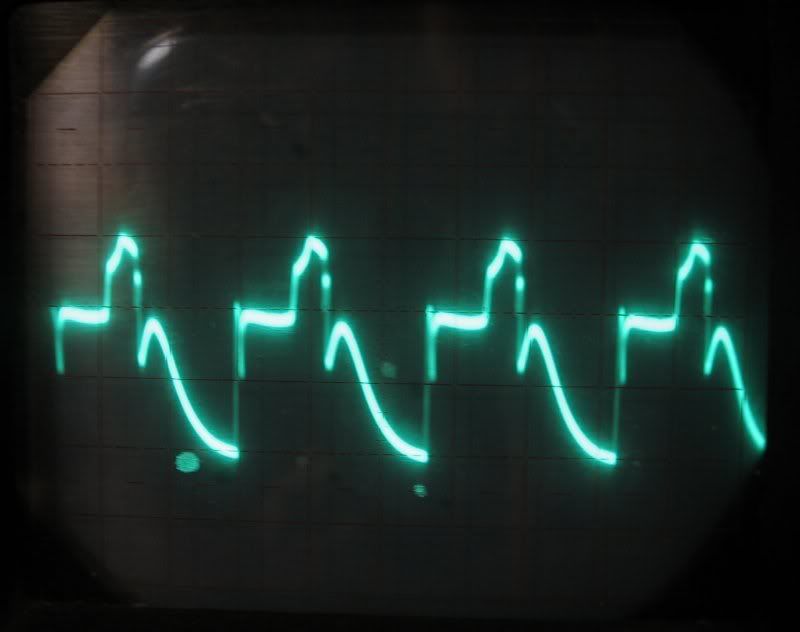

I've got finally an oscilloscope so I'm playing with interrupter for start :)

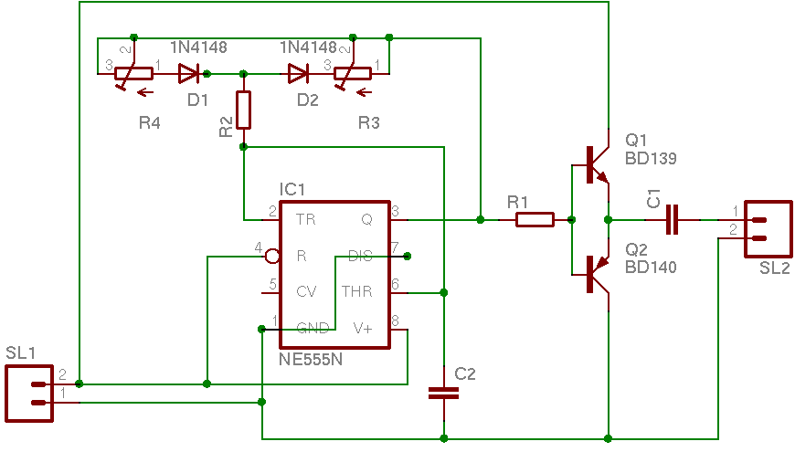

I've decided to try with NE555 since it's cheap and easy to get. After seeing many NE555 scheme's, I've made this one:
R3, R4 - 10kohm variable resistors
C2 - 1nF
R2 - 2kohm
C2 - 2uF DC blocking capacitor
And that's how it looks:
Now, let's start.

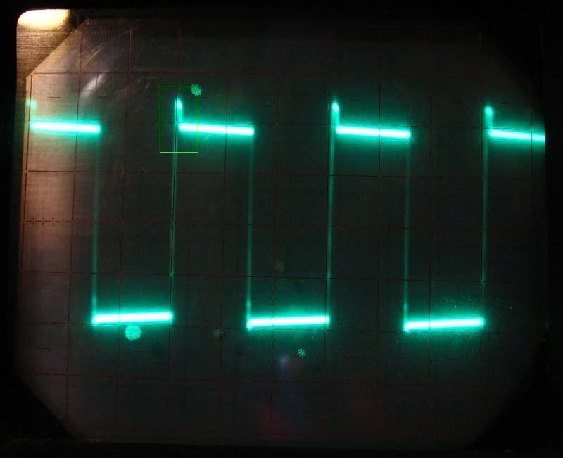

NE555 works at 150~ kHz frequency and makes nice square wave, but one thing catched my attention. I marked it with green rectangle:
How it's called and how it can be solved?

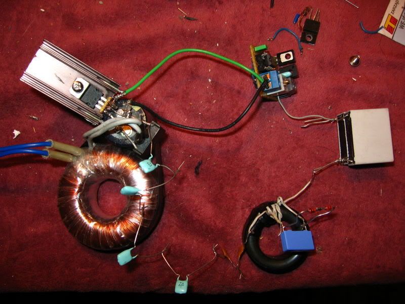

Next, the whole config:
It contains main transformer+LM7812+10000uF, NE555 interrupter, two gray blocking capacitors, GDT and a series of capacitors. Question - if I don't use this series of capacitor between GDT and minus, square wave gets completely ruins. Why it's that? The capacitance of this series isn't calculated yet, but it's small, in nanofarads range.

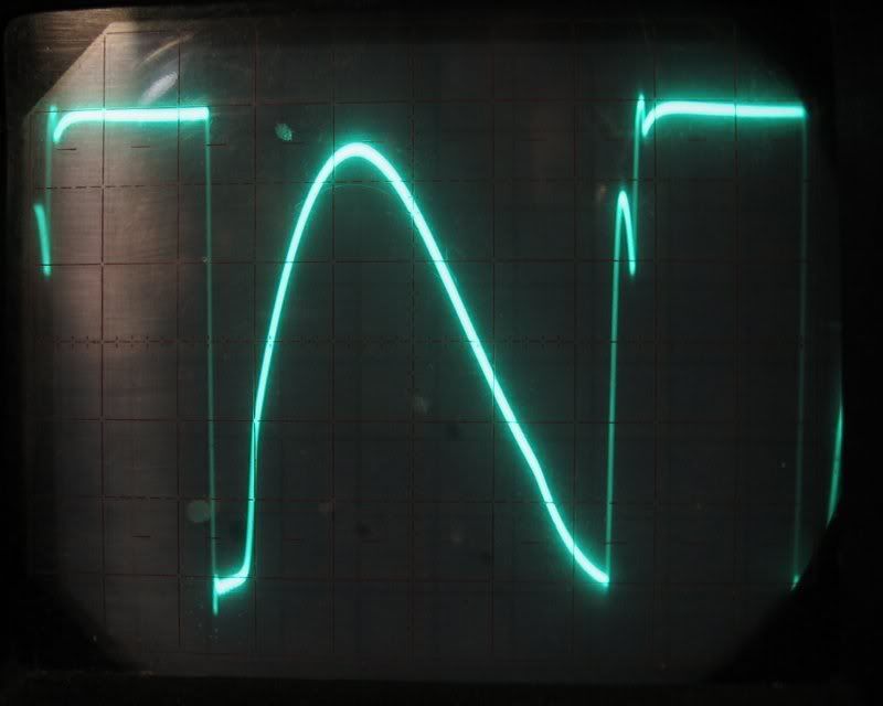

When I connect a GDT without load on secondary (the wire I used came from hard disc drive cable and I twisted, the number of turns is 4, ratio 1:1), I get this wave:
It's called overshoot, can be damped with fast clamping diodes (Schottky preferred) to + and gnd rails.

Take a closer look at config photo - you can see that one wire from GDT goes to one end of capacitor chain. Second end of chain goes to rectify bridge, to GND. I've updated scheme, there you can see: Link2
I've calculated also a total capacitance of this chain. It equals to 150 pF and turned out that those 220nF capacitors didn't change much at all, it mainly thanks to 300pF ones.
Tell me more about it, I'm really green in those pulse things. More than one Shottky? What about parameters? Across where exactly? And how it works?
One diode from output to +V rail, anode on output. Second from output to GND, cathode to output. These diodes will clamp the output voltage so it cannot go any higher than supply voltage and any lower than GND. However the overshoot in your scope shot is doesn't seem any harmful.
Tonic wrote ...
Tonic wrote ...
I don't know how exactly are the caps connected so I cannot comment on this.
I'm surprised that it actually works with the caps, why did you connect them like this? Connect the lower transistor collector to GND directly.
You also should put a ceramic/foil cap at least 100nF (preferrably more) from +V to GND, to kill any HF oscillations occuring on the +V supply. This is called decoupling capacitor and they are critical in any HF/power circuits.

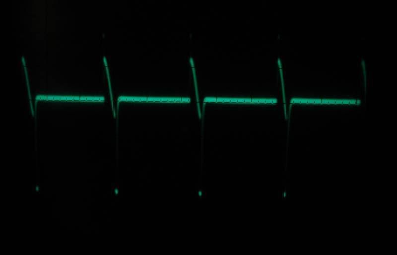

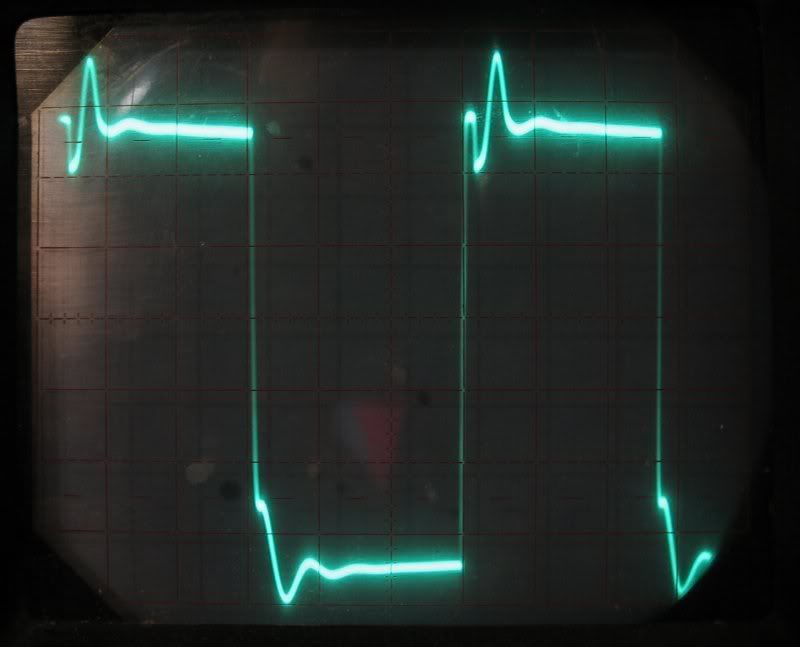

Without them signal gets completely ruined - there's photo:
jmartis wrote ...
I tried with 200nF and noticed a slight frequency increase. Ruined waveform didn't change at all, it's still too far from being a pure square wave.

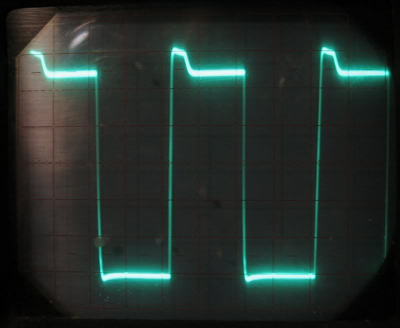

Finally, I've managed to remove this chain of capacitors and get a square wave.
It was my error and I'm ashamed of this. The reason why I was getting ruined waveform every time I plug GDT directly to ground, was the fact I forgot about previous DC blocking capacitor. In first revision, I used 220nF capacitor (you can see it on PCB). After some reading, I came to conclusion that is too small capacitance to block DC signals, so I've added two 1uF capacitors (grey ones on photo). I was scatty and forgot about previous capacitor which remained connected in series to those two 1uF's. So, total capacitance was lower! Around 200nF. After I figured it out, I removed old capacitor, chain of capacitors and plugged GDT directly to GND. Voila! It worked :) Duty cycle was out, but I did easily set it to 50%. The waveform without GDT is similiar to one before change, but the major difference is that this new has 500kHz frequency instead of 150kHz:

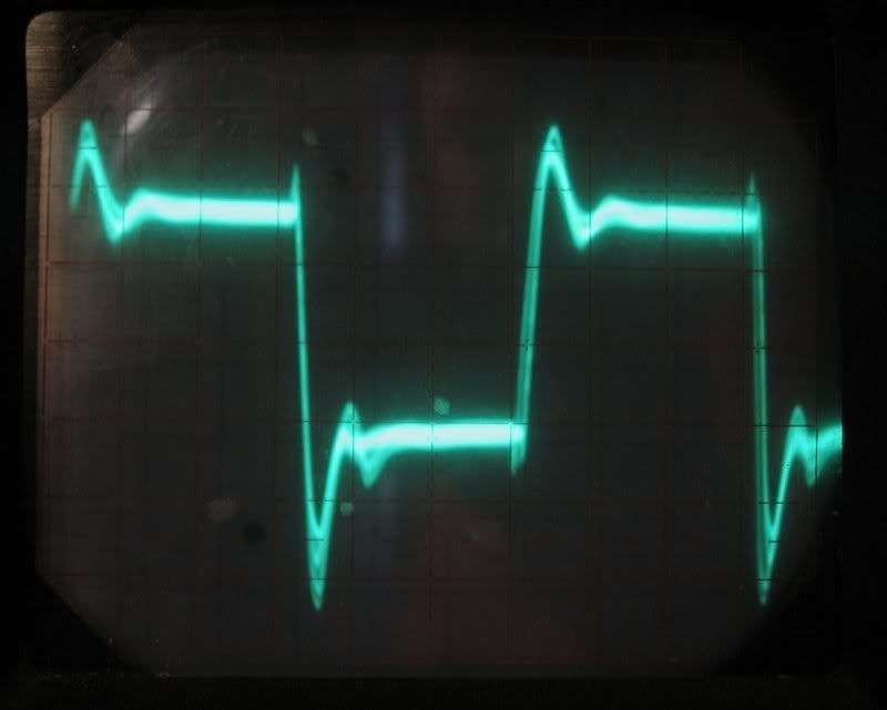

I think that NE555 driver is working properly and now it's time to work on GDT, where I do still have problems. When I plug IRFP450 and 10ohm resistor to gate, I have this waveform on primary:
On secondary I have sinusoidal.

Removing the 10 ohm resistor will help somewhat. Getting good gate drive with BD's at 500kHz is pretty tough, and I wouldn't recommend you bother. Use a smaller gate resistor, 2.2 ohms or so, and drop the frequency.

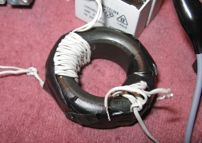

I've added capacitor to C2, so I'm getting 50kHz frequency. After rewounding bifilarly GDT to 10 turns, things get worsen. Just see two photos:
Rewounded GDT: Link2 (the new windings are on left side)
GDT waveform: Link2
Without load, waveforms on primary and secondary are practically same. Adding load doesn't change much.
Now, what to do? wink
Maybe I'm not right, but using Shottky's diodes or changing gate resistor won't help, since they're just factors that improves driver working, and aren't supposed to decide if anything will work, or not.
Seems a lecture of thedatastream's informations is waiting for me :)
Sat Nov 24 2007, 08:39PM
By dropping the frequency by a factor of ten, you'll need a lot more turns on the GDT. Otherwise it will saturate and give you poor waveforms. Link2 Calculate the number of turns required for 50kHz and you should get proper waveforms.
