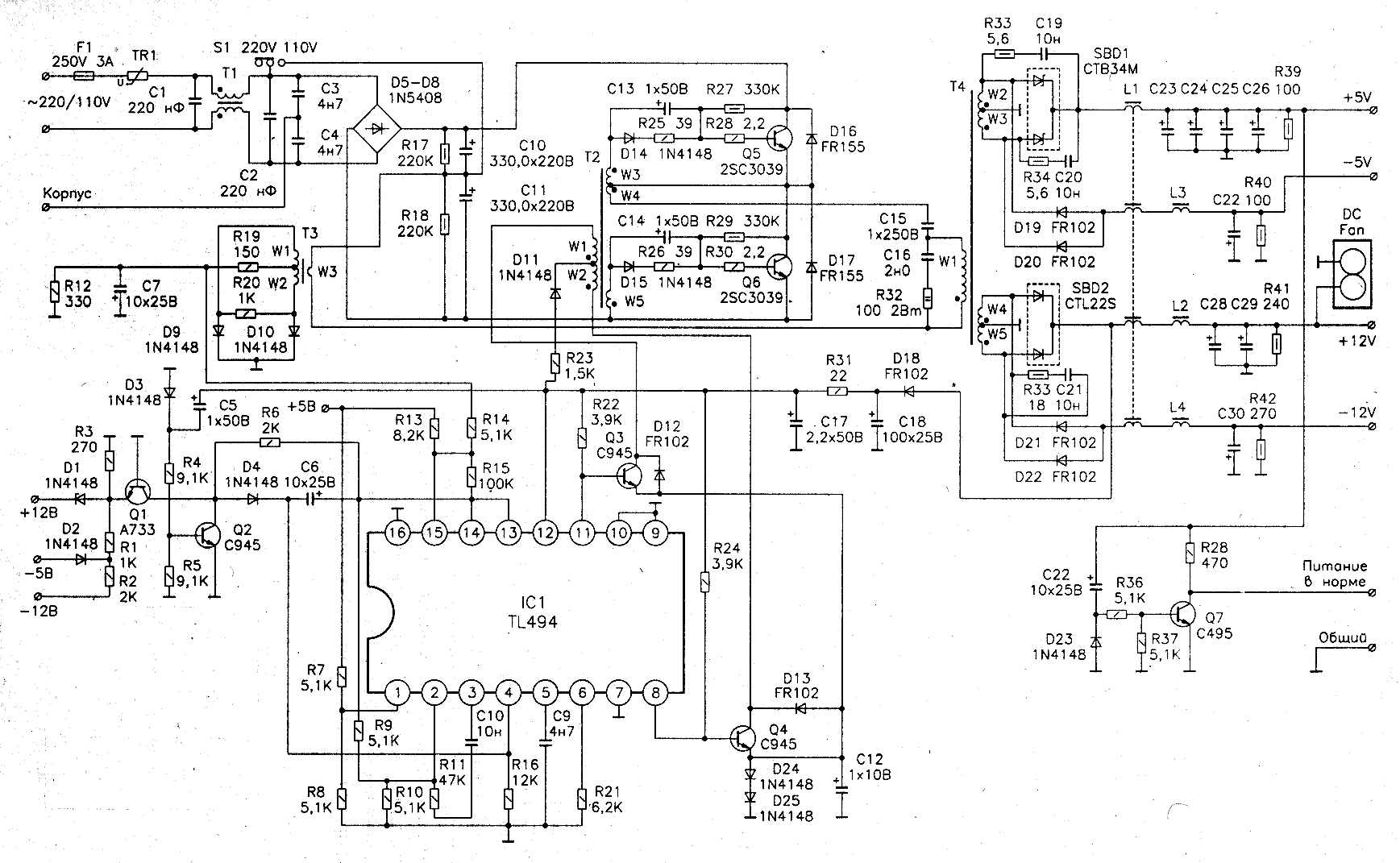

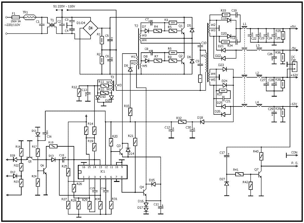

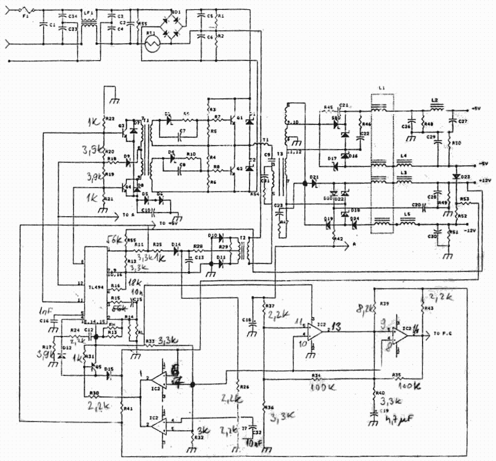

Take a look how is it done in AT supplies:
