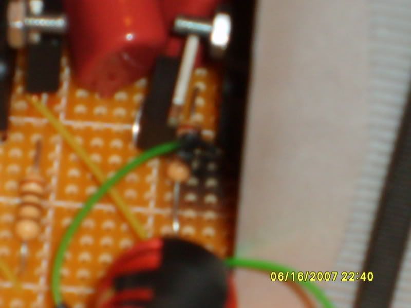

Well the wire came in today while I was at work, for the SSTC that I'm working on. Which is built on Steve wards Mini-SSTC, with almost identical specs...coincidentally. Still waiting on parts to arrive for driver and power electronics.
So far here is the progress, I managed to get all 18" on the coil wound with 30awg wire in about 3.5 hours.
The pictures of the finished coil on the winding rig, and on a table finished and drying. The rig is two lawn chairs supporting a threaded rod that ran between the two chairs and in the middle of the coil.
I sorta fixed the linking, For some reason the image resizing thing isn't working for me anymore.
Update: Sat 10AM:

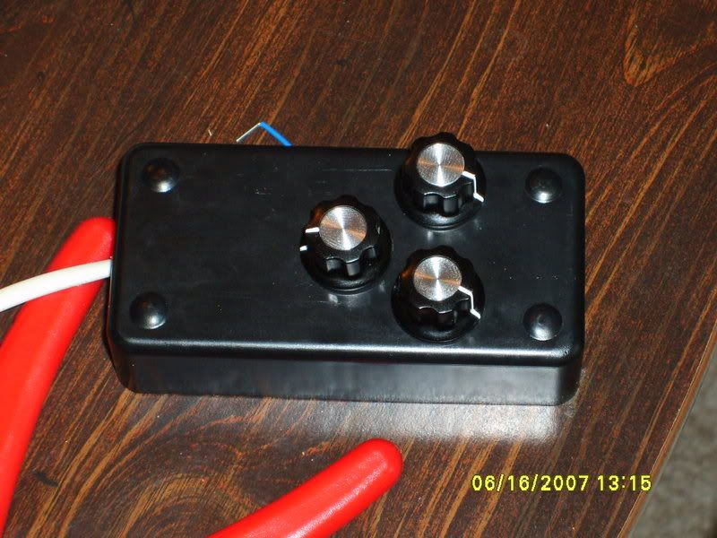

Well All my parts came in on Thursday and I started working on it so far everythings working fine minus the little GDT issue but I believe thats been fixed. Tried to build the remote interuptor, but it failed so I'm gonna try and fix that today after I get a new perfboard from Radioshack along with some thermal compound since I'm out, I'll add some pics of the progress after I get everything soldered and boldy go into the 120VAC powering stage.
Things to do still:
Make remote interuptor work in control box
Solder drive and power electronics to perfboard
Hook up coil to electronics and test
Make topload
Make housing\stand for entire system
Post pics on forums of progress angry
Update time 11:30PM saturday!

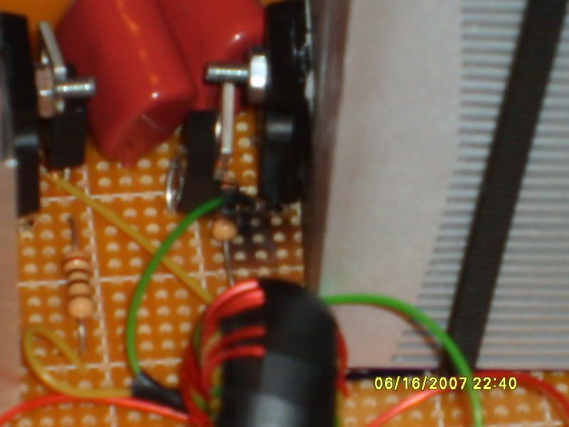

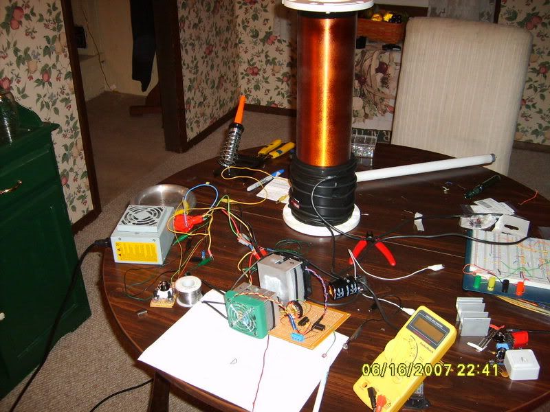

Well got everything soldered and on the perf boards was testing UCC outputs when the 1st casualty hit Link2 ,luckily I had a replacement one, after I got that I figured it was time to take a pic of the boards progress before I got the power caps, power lines, and recovery diodes in Link2 , Well Managed to get the whole setup semi wired and tested and here what the setup looked like Link2 ,Fired her up and was getting kinda crapy arcs almost as if I was just running a micro coil with 5v's input, it was enough to put a blue plasma ball ontop of the wires tip, and arc to a florescent and light it up, but other then that it was crap, Except for whe never I'd switch to a different interuptor value it would do a massive 4in discharge (So no pics of it running frown ). Anyways I switched the primary coil around and stopped teh interuptor halfway between two settings and I was able to produce some really nice arcs for about 10seconds then the dining rooms circuit breaker popped (20A) sad, left the power electronics plugged in and flipped the breaker then Boom the (-) rail fet's gate drive resistor flashed over I think... Link2 , Link2 . Just noticed I forgot to insert the pics of some of the setup, Link2 , Link2 , Link2
Wed Jun 13 2007, 02:40AM
Your links are broken in several ways.
In any case, how much power are you planning on running?

As for power....I guess what ever the bridge rectifier will limit it to...which is 10A, so I guess 1.2kW. I never really thought of how much power I was going to put into it...

I'd get a bigger bridge rectifier- with a secondary that size, the rectifier will most likely be the limiting factor- I had a 10A rectifier, and was running 16 inch sparks on a 4" by 12" secondary- however, CW i was drawing nearly 2kw, and the rectifier blew after some time. What MOSFETS or IGBTs will you be using?
