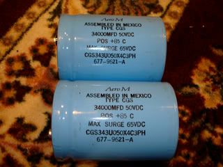

Billybobjoe
Sat Apr 07 2007, 08:49PM
Billybobjoe Registered Member #396 Joined: Wed Apr 19 2006, 12:55AM
Location: Pittsburgh, PA
Posts: 176
Tadaaa!! DSC02322 (Those are mine)
Like others have said, I'm not sure these will provide enough current for spotwelding anything substantial.
Sun Apr 08 2007, 12:10AM
IIRC 500,000 uF at min 25V is required, so you'd need 5 in parallel.
In any case its always better to use an array of small capacitors rather than one large (and expensive, and fragile) capacitor, the ESR is always lower.
To switch, use an SCR on the -ve side as its far more precise and you can include safety systems.
