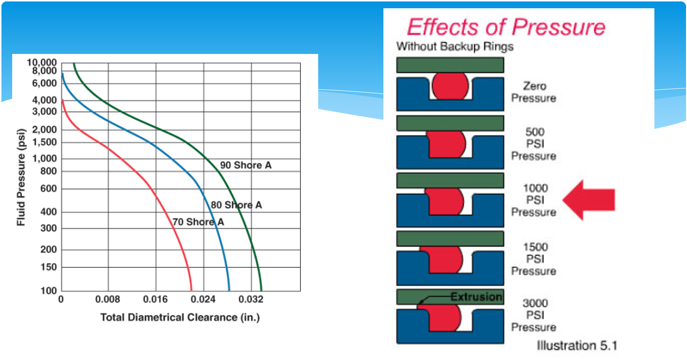

I was thinking of building the body out of aluminium, I'll look up cylinder pressure math. Filling with oil sounds like a pain. Following the chart below, o-rings don't sound so bad unless I am missing something:

That sounds like an effective method, the epoxy inside the pipe will probably seal OK against the cable, a quick release connector (or other air fitting) can cope with 10 Bar without leaking if it's in good condition, the most probable ingress point will be the seal of the fitting onto the enclosure. When working with air systems that always seems to be where it leaks, and a few cubic inches of air escaping from a fitting over the course of 10 minutes is completely unnoticeable, but a few cubic inches of water could destroy everything.
Another often overlooked ingress point is the gap between the wires in the cable and their sheath, as well as the gaps between the strands of copper and the plastic. Water can wick down there with no external pressure at all. Both ends of the cable need to be really well sealed, otherwise a single leak anywhere can compromise the whole system.
I'm not sure what the porosity of a typical rubber cable is under several bar of pressure, but I would try to run all the cables inside air pipes which will remove the risk.
The only trouble with your method is that it's difficult to change anything; you have to desolder or remove the plugs on the things inside to remove the pipe from the fitting, and every time you do that you are increasing the risk that you have made something leak. A vacuum pump can help tell you when something has a leak, but the differential pressure at 300 ft is greater than 1 atmosphere, so a pressure vessel you could put it in would be more useful.
