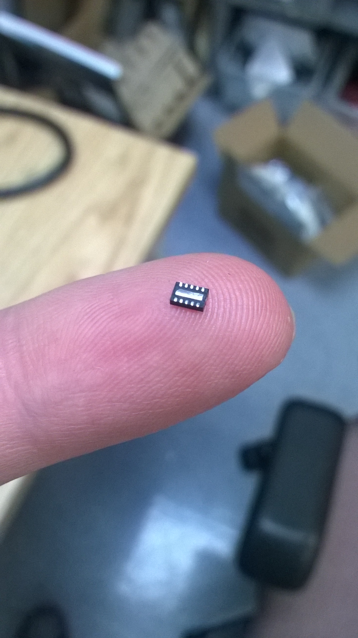

This is the smallest chip I've ever soldered. It is a backlight driver for an LCD display on a proto build. A bit of skill and a lot of luck.

WOW that is pretty small lol Thanks for that link I will keep them in mind I am discovering this card is not worth it But its great for the experience. I can get cad for the stencil design I have used Eagle at work I could use some practice for sure lol
