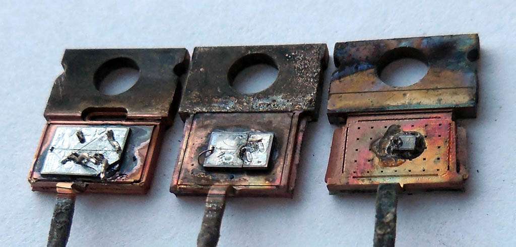

I don't know if this is common knowledge around here, but it seems like a lot of the chineze electronics on ebay are suspect at best. They seem to have no compunction about fraud. As an example, I purchased some IRFB4227 FETs from 5 different sellers, all with good seller ratings. I received 5 different types of FETs marked IRFB4227, but none came close to the datasheet. Basically, this should be a 200v FET with a Rds of 0.02ohm. The articles I received ranged from 0.05ohm to almost 2! I tried to use one part and it died around 100v. I have a part I pulled from a board (probably genuine?) that does have a measured Rds of 0.02ohm, so I know it's not how I'm measuring them.
The ebay return policies reduce the risk of buying from these guys, but I would be suspicious of anything you get from them...

Out of curiosity I opened a few of the dead ones. Can anyone spot the fakes? :)
Fake FETs
Wed Sept 26 2018, 05:48PM
The left hand one looks fake, die is off centre. Right hand one looks way too smal Middle *might* be genuine.
The middle one is also off-centre

The internal placement and size shouldn't be an indicator nessicarilly, I think. In most cases I think they carefully grind off the existing part marks then remark them by laser or whatever.
