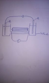

Plasma
Tue Sept 04 2018, 02:25AM
Plasma Registered Member #61406 Joined: Thu Jan 05 2017, 11:31PM
Posts: 268
This thing is a cross between a battery and transformer, would the ac magnetic field increase the cell voltage of the battery and the plates supply the charges.

Tue Sept 04 2018, 08:56AM
Vaguely recall reading that someone had made one using a monster neo magnet (the flesh-crushing sort) and it worked very well. Alas not efficient at all even in salt water compared to a superconducting magnet but enough to get an honourable mention at science fair.
klugesmith
Wed Sept 05 2018, 12:05AM
Posts: 1716
Just remember, MHD pumping of seawater (or liquid sodium, in real nuclear reactor plants) has nothing to do with the Hall effect. It's plain old force on current-carrying conductors in a transverse magnetic field.
Here is one distinguishing feature of the Hall effect, which is typically very small in magnitude:
The sign of the voltage tells whether the moving charge carriers are positive or negative.
Hall worked in the late 19th century, before the discovery of electrons (much less the electron theory of charge conduction in metals). But after electric motors and three-phase AC power distribution were well established.
Hall's voltage measurements, on thin metal films with huge current densities, indicated that most of the current was being handled by something with a negative charge, moving counter to the electric current direction. Something that wasn't moving very fast, so it must have a very large charge density (many coulombs per cubic mm). Today we refer to the drift velocity of electrons.
