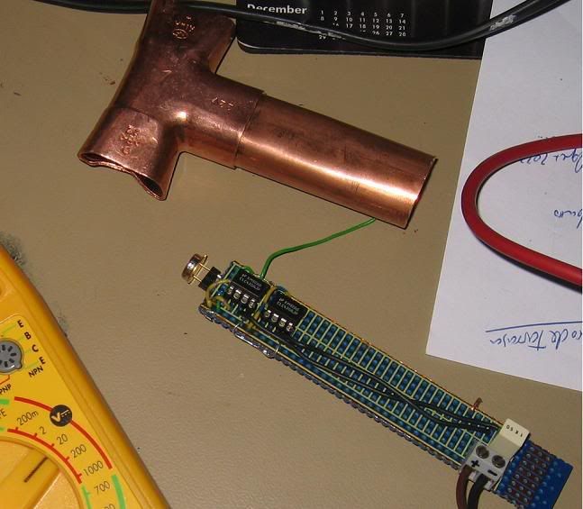

Now I have done an Ultraviolet sensor with its transimpedance amplifier:
Dibujo107
*** mod edit, image too big, 400 pixels width max please ***
Then I placed it in a copper tube with a hole in order to avoid RF:
Then I made a spark and had a plot but I am a very bad photographer:
I obtained a 700mV peak! thats corresponds to 8.42W of UV.
I surprised a lot because voltage was drop in only 12microseconds, but UV burst stayed up to 150us, so how it is possible that after copper wire blast there is still UV sending?. Sensor is OK because I tested it and frequency and voltage coverage was good. The only explanation I have is that copper atoms stored the great magnetic energy that could not be dissipated and released it as UV.
