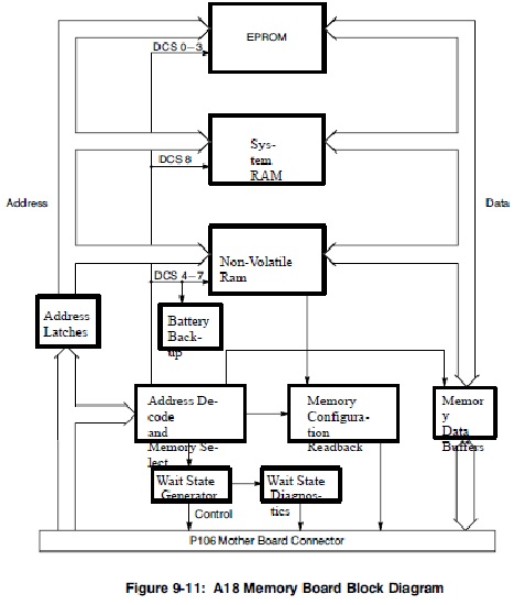

The service manual of the Tek 11801C unfortunately gives only this information:
Battery11801C
4. Does somebody have more information about these special ICs?

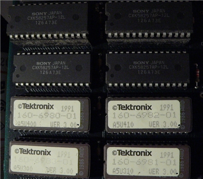

You simply need to replace the NVRAMs. I repaired a CSA803 (essentially the same instrument) in this way. Just make sure that you are getting 'fresh' ones, they only have a 10 year life from the date of manufacture so 'new old stock' units are likely dead by now. The instrument will self calibrate after the replacement units are installed.

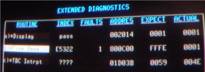

Thank you for your comments regarding the error messages E5622 and E5322:

had a friend of mine (professional electronics engineer) and me after 3 hours work success with a Tek 11801A:
chipset

One of the error messages:
P1190762400x141
