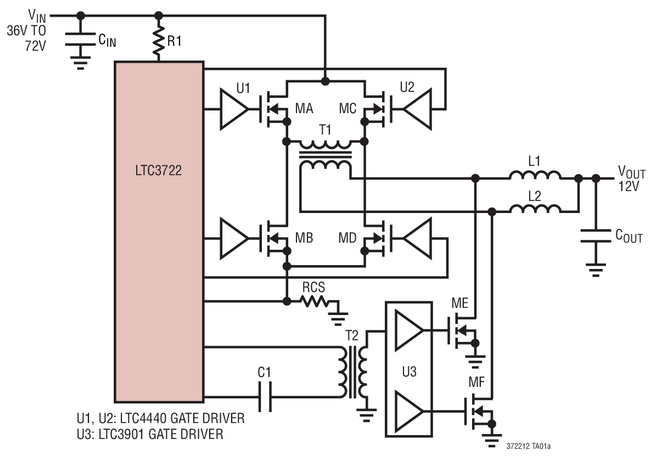

My goal is pure sinus driver with ability to have 1-2KHz sinus wave. So what i can do is to use 3 phase shifted DCDC converters with synchronous rectification, run this device at 200-400KHz with some SiC mosfet on 220 or 3 phase power input, so i have small power dissipation over large area.
1477566679 1143 FT178055 Untitled
In synchronous rectification i will use multiple eGaN mosfet's because i don't think i was be able to have batter heat performance . As a bonus, this system should be very rubust, because H bridge will not see any nasty loads and back EMF, that would kill Buck converter, and rectification mosfets can be very high power and they are so easy to drive.
From controller point of view, all i need is to have 3 analog sinus generators that connects to comparator, and LTC3722 will do the rest.
DerAlbi
Thu Oct 27 2016, 07:20PM
DerAlbi Registered Member #2906 Joined: Sun Jun 06 2010, 02:20AM
Location: Dresden, Germany
Posts: 727
Linas, think about what you are actually doing maybe another way:
You could also call your setup a "Class-D Audio-Amp" which shall produce a good since wave. I hope you agree with that. Motor <-> Speaker. Both inductive Energy converters. wink
Now look at Class-D Amps. Their design problem is also the high switching frequency, because they are actually just step down converters with an active diode (sound like your design, right?)
Now.. the typical tradeoff in these Amps is "Switchingfrequency = HighestFrequency*10". Leaving an audio-amp with 200-300kHz operation frequency which is deemed sufficient to produce a high quality signal.
Applying the same rule to your design you would end up with only 20kHZ switching frequency which would produce a clean enough sine wave given the right filter. However i would say this frequency can be audible and might lead to audible resolution problems on lower RPM, so i would suggest a higher frequency. As said before: maybe 40kHz - 80kHz.
This must be a tradeof beween inductor size and switching losses and at this power levels this should be an educated decission instead of a wild guess.
I mean.. whats your (engineering)argument to go for those insane high frequencies?
Dont tell me its signal fidelity, because my next question would be why a motor would need that wink
Some additional thoughts:
The problem is that your mosfets may have nice characteristics, but 7mOhm is not that low for that kind of load (high current). The power dissipation capability of the package does not seem good, except you manage to put an SMD-heat sink on top (but i dont think thats enough).
So the road will lead to other mosfets. To combat the very possible worse switching behavior of other mosfets, use a lower frequency.
