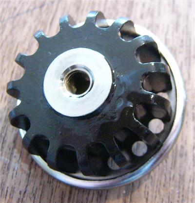

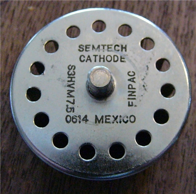

Please, who could perhaps know something about this high voltage circuit from an electronic flea market?
Kaskade1400x291
12 high voltage diodes

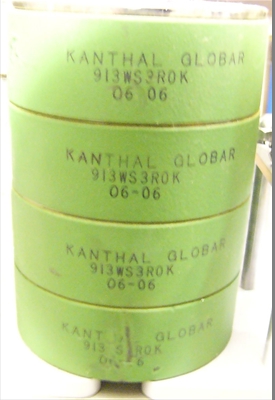

parallel 12 high voltage capacitors 420pF/30kV
Kaskade3400x234

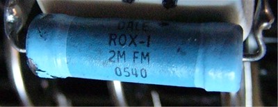

parallel 12 resistors 2MOhm/5W?
Kaskade5400x154
at the right hand side of the first picture, is this a voltage divider with a visible 20 MOhm resistor and another not visible resistor with a BNC connection?

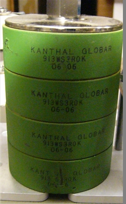

Here are more pictures of this circuit:
P1760148400x246
P1760151400x275

google Siemens high-voltage diode assembly
As far as I can see the left bunch equals a diode
the middle bit? 12ohm+a diode
right bit voltage divider output for measurement
Looks very clean
Some data sheets

that Dale ROX resistor looks like 2M ohms to me ?
