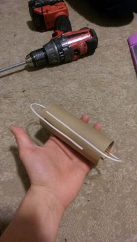

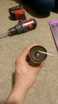

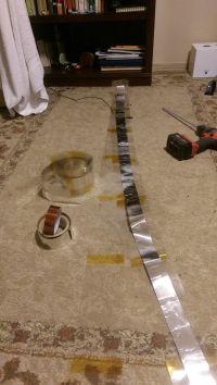

I am making some HV rolled caps with aluminum tape and 3m projection sheets and plan on using a low vacuum and some sort of potting compound (not oil). I was wondering if this Link2 or something like this would be a good choice for some added insulation and corona suppression. Is there anything else anyone has used similar to this with success? Im only looking to opperate these at or below 8-6Kv but i dont need the epexy to be able to withstand that much, just looking for the added insulation.

I would consider a silicone potting compound, something like this Link2
since there are three different materials; dielectric, plates and potting compound
a flexible compound would withstand differential thermal expansion better than a rigid epoxy .... I think
also, the lower viscosity of the silicone compound may allow bubbles of air to escape easier.
this is all guesswork, I have not tried it.

Thanks, its currently unavailable though, but i will look for something like it. I dont think thermal expansion is going to be an issue its quite large and with the amount it will take to fill it it should be very solid.
Edit: Pics are to large to upload apparently, im not sure how to fix that or upload them somewhere else

whatever you use do a test run first as some of these two part compounds can heat up quite a bit

EDIT: BTW, I picked up some 'dielectric grease' to suppress corona in these, but I've not got round to rolling mine yet. Just waiting until the kitchen table is clear/free.
Wow, that stuff has a crazy Kv/mm rating. Might have to get some of that.
