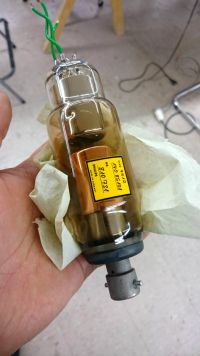

I decided to take a look inside my fluoroscopy x-ray head. Here are some pictures:
This head came from real time x-ray fluoroscopy machine and was rated for 3.1mA 100kV operation.

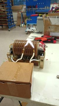

Transformer out of the box, its a iron core transformer that is designed to run at 140-400V and 300Hz.
1431253819 599 FT0 Image001
Secondary is diode split
1431253838 599 FT0 Image008
The transformer works on 50Hz too, but only up to 100VAC

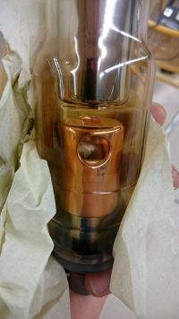

Tube was surprisingly large and in very good condition. Anode is nice and shiny, filaments are good. I found out from the service manual that the tube is rated for 110kVpk 20mA operation in normal xray mode where exposure time is below 320ms.

Interesting photo's of the transformer windings. Thanks for posting smile

Beautiful transformer smile Thanks for shearing Kizmo

I have the same xray tube. These are compact, yet very useful. I made xray pictures with 500uA around 60kV for 30s with speed 100 intensifying screen.
