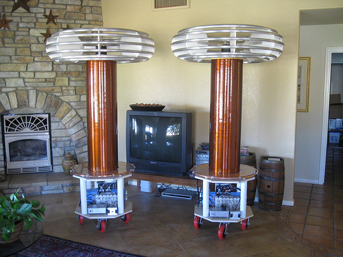

Hello, since i am redesigning my top-load, one thing does not make sense. Basically, toroid is short turn on top of coil, so it will degrade performance of last secondary windings.
Does any one investigate this ? One simple solution will be to make toroid with a slot, other is to make topload from tube, by winding it on isolator, like this this
Thu Jul 24 2014, 11:53PM
Yes the topload will divert the magnetic field and cause less induced voltage on the top turns. However from my findings the difference is not that big. Losses in the topload can be a problem with high powers/duty cycles. Making the topload as an incomplete turn could be a good solution but avoid sharp edges which could cause an unwanted break out.

I would assume the coupling from the primary to near the toroid will be near non-existent so the effect is very small.
Fri Jul 25 2014, 07:06AM
If the toroid is made out of aluminium, that is a highly conductive metal, so instead of absorbing the magnetic energy it will reflect it. The inductance of the secondary will be reduced slightly, but the losses won't increase a great deal.

Linas wrote ...
Goodchilds and Catons coils uses complete rings for the topload which are all connected to eachother and the secondary coil, so they present the same one turn as a large toroid would. The dics material is only chosen for ease of sourcing/machining/weight.
I also doubt that it absorbs much of the energy directly from the primary as we usually have much else metal in the bridge construction underneath that is closer to the primary.
One thing that could be interesting would be to make a ringed topload where every slot in each ring, to not make complete turns, was connected in series so instead of being one big end terminal it worked like an extension of the secondary coil, I do however have no idea how that would affect the coils performance, just a thought.
