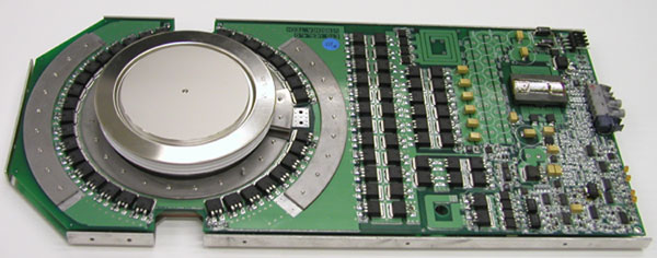

Dr. Slack
Wed Apr 09 2014, 04:21PM
Location: UK St. Albans
Posts: 1659
OK Steve, tease/troll successful. What is that bit of power pron from, and what are its specs?
Ash Small
Wed Apr 09 2014, 05:14PM
Posts: 4245
Dr. Slack wrote ...
It's one stage from a pulse generator, it consists of a toroidal core with a one turn primary. The secondary is a shaft which fits through the hole in the centre. These stages are then stacked.

Dr. Slack wrote ...
That looks like a part from a locomotive drive.
Steve Conner wrote ...
Below a certain frequency (which due to the above relationship, also implies above a certain power level) GTO thyristors will become more cost-effective than IGBTs in solid-state coils. I estimate this happens around 10kHz and 100kW average power.
Hm?
I was under impression that SCRs don't work well or at all above a few hundred hertz, which is a couple orders of magnitude too low.

Dr. Slack wrote ...
It's a GTO thyristor assembly from an electric locomotive. I don't know the exact spec, but it will be thousands of amps at a good few kV. The large round object is the thyristor in a hockey puck package, and the smaller semiconductors clustered around it are the gate drive. A GTO is easy enough to turn on, but needs a huge pulse of current to turn it off.
GTOs switch somewhat slower than even the slowest IGBTs, but they're still a lot faster than 50Hz. In a DRSSTC application, the resonant load would help a lot with turn-off.
I will get my hands on an H-bridge of these one day. >:)
