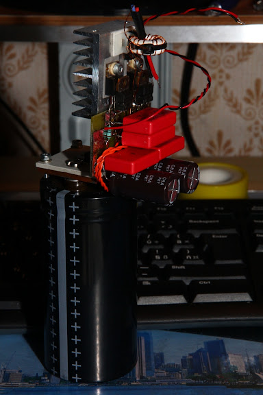

I also wanted to build another bridge to see how smaller gate capacitance can impact performance (or i was just bored). Link for photo of halfbridge.
Worked marvelously, i could drive with it even my worst nightmare 2.2MHz TC (which is hard to get feedback from, needs to be driven from generator). If consists of (now) old IRF510 mosfet which has i think 180pF gate input, 2.2nF WIMA FKP1 caps (2 for decoupling, 2 for voltage divider), and 3 electrolytics, which the biggest one is 1500uF / 450V low impedance one (i wonder if that low impedance matters with such a low power mosfet). The big elyte is important, without it the voltage was getting crazy. Also, smaller elytes should be low impedance too ( before that i had some 470uF/200V from PC powersupply and that worked better than current ones, but they had shorter leads which did not allow me to mount bigger elyte. I need to order pair or better ones, but possibly smaller. 47-100uF could be enough.

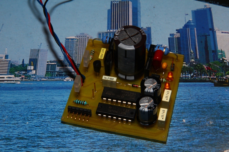

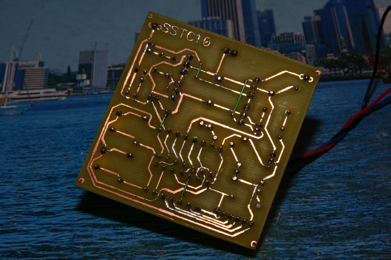

Shame on me i don't have any spark photos (but it will be), currently i am working on transferring my driver into metal box, first part of driving board is done, but i still need power and interrupter board (modules are easily manufactured for me, and driving board was a test of making board with laser printer)
IMG 9138
IMG 9140
That board has everything needed to run GDT, so it would be enough for SSTC, but output transistors does not have heatsinks so it would be only short run. I have headers for 4 enable inputs , so 2 will go for interrupter (for each channel) and two for safety voltage comparator (if voltage for GDT driving circuit gets below 12V, it stops oscillating). Two power resistors needs to be more powerful ones! At least 5W for 15V gate drive, they get hot (i mean 5W ones get hot, this ones get hot even at 7V). This was only for testing purpose to see if bridge is working.
I expected that i would get pretty clean waveform , but no - there is ringing again! Eagle eyed person could notice i forgot to add schottky diodes to transistors ( well i did not had any place for it anyways), so i need to solder them from bottom, and also put decoupling caps across ICs.
