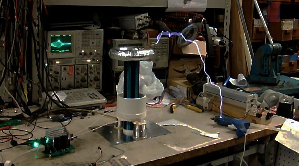

Inspired by EVR's microBrute, I decided to route a DRSSTC onto a 4"x6" board.
The result:
Half the credit for this project goes to Daniel Kramnik, who built the coil in the video above using his revision of my design (which includes an optical interrupter).

thats pretty awesome. how long of a streamer can you get in free air? what does the interrupter look like? is over current protection not needed in little coils?
I can get 6-7" in free air; note that the entire coil floats, so this may be limiting my streamer performance.
The interrupter is microcontroller with optocoupled output.
I've yet to need OCD on this coil. The bridge seems to hold up fine during ground strikes.

if you ground it you not only will get longer streamers, but the audio will stop crackling too. that's because the crackling is caused by the streamer having trouble breaking out. notice how you get perfect audio quality when you get "ground" strikes.
but on another note, very nice! i saw this somewhere a couple days ago, but good to see you have finalized it.

Excellent IGBT choice smile. I say this because i use that part for some other projects of mine and im very happy with them.
Have you reached a point of part failure? or have you simply limited the on-time and current to be "safe"? I suppose your single MMC cap can only take so much as well.
Maybe also consider using 2 separate heatsinks so that you can directly mount the IGBTs and avoid thermal resistance of an insulator. At least i'd look at that for maximizing the performance of those parts.

I've yet to reach IGBT failure on the 60N60's; on the old bridge (FGH40N60SMDF) it would silently die at about 300A. Been meaning to push the coil to the point of destruction, but I'm out of 60N60's for now tongue a few transistors gave their lives due to human error.
Here's a new video with streamers; tying the secondary base to earth ground worked wonders. I also added a low-pass filter (R and C in parallel to ground) on the feedback pin on the 7414, which got rid of the static-ish noise in the first video.
