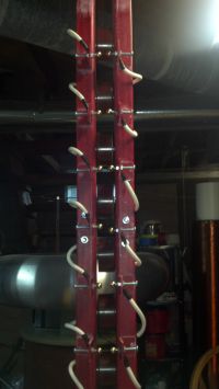

Dr. Brownout
Fri May 25 2012, 11:21PM
Dr. Brownout Registered Member #2405 Joined: Fri Oct 02 2009, 12:59AM
Location: Wisconsin
Posts: 140
The Marx Generator I spoke about is underway. Lots of bolt trimming and "corona be gone" work to do, so lots of work left on it but its slowly taking shape. Its going to be powered with 25kV. The caps are rated at 30kV and are 2700pF each. There will be 10 stages.
I am going to use a 12 / 60 NST rectified into a CW voltage doubler, voltage into the NST will aprrox 80Vac. That should get me not to far below 25kV. Total power should be around 8.5J. No record setter but it should have a nice pop to it...:)
--Brian
1337988057 2405 FT138469 Marx
1337988057 2405 FT138469 Marx Const3
1337988058 2405 FT138469 Marx Const2

Dr. Brownout
Mon Jun 04 2012, 03:19AM
Location: Wisconsin
Posts: 140
I managed to get back to work on the Marx, for the test run I am using a 3kV NST run into a voltage tripler. Input to the NST is 100V. Charging resistors are 1Meg carbon comp resistors and they wont take much more. So I will need to replace them with some decent resistors but for now I used what I had on hand and they seem to be working at least for the moment.
The caps are 30kV at 2700pF.
Spark distance at this voltage input level is just over 5 inches which tells me I m somewhere between 100kV and 110kV or so, firing is pretty consistant with one fire every 9 to 10 seconds or so.
I attached a picture. I turned off all but one small light so the pic is a little dark but not too bad,
--Brian
1338779956 2405 FT138469 Marx1
