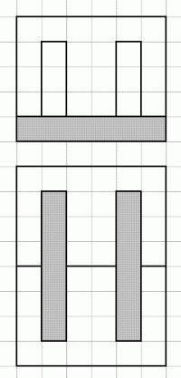

I've got a bare MOT core right here. I don't see a power rating on it anymore, but it was a 120v 60hz pretty average size one.
cross section of center leg is 2.4"x1.4" and it is 2.1" long.
side legs (and the size of the winding window as it turns out) are half that, at 2.4"x0.7"x2.1"

klugesmith
Mon Apr 02 2012, 07:10PM
Posts: 1716
Forty's numbers match the "golden ratio" for transformer EI cores.
Perhaps not optimal for VA per pound, but the steel shapes can be punched out without wasting material.
